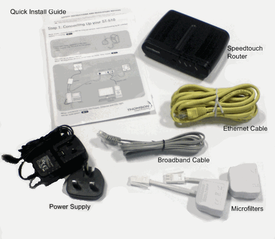

Your hardware pack contains:
01-pack2

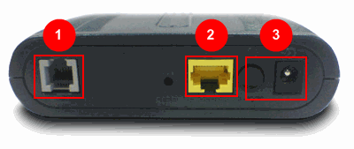

router1
  1. DSL socket
  2. Ethernet socket
  3. Power socket and switch
