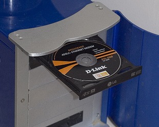

1. Before you begin plugging everything in, put the setup CD into your computer's CD/DVD drive. The disk should automatically play, loading the start screen.
dsl320b_cd

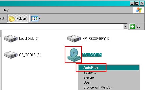

If not, you can click the CD icon with your right mouse button and select Autoplay
from the menu.
dsl320b_autoplay

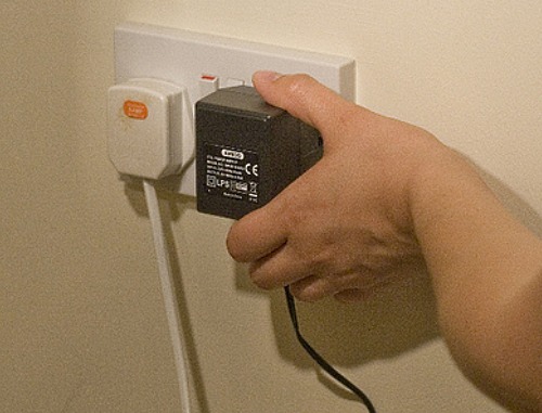

5. Plug the adapter into a power socket, make sure the
power socket is switched on.
dsl320b_plug

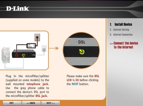

11. Connect your modem to your telephone line.
dsl320b_setup4
12. Plug one end of the DSL cable into the microfilter socket marked 'ADSL'. If you also want to use a telephone from the same socket, plug it into the
microfilter socket marked 'Phone'.
Plug the microfilter into your telephone socket. You'll need one microfilter for each device that uses your telephone line (Sky, fax, additional handsets).
For more information see our Guide To Fitting Microfilters.
dsl320b_microfilter
13. Plug the other end of the DSL cable into the socket on the modem marked 'DSL'. When the DSL light on the modem stops flashing and stays on, click Next.
If the DSL light doesn't come on, or doesn't stop flashing, go to Troubleshooting.
dsl320b_dsl

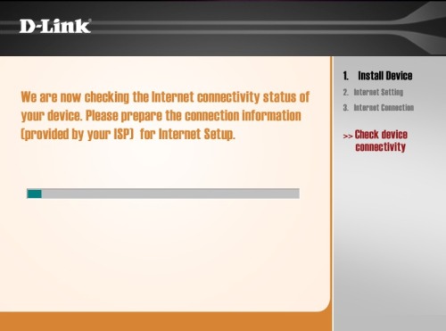

14. The modem is now set up and will try to detect
your broadband service. Wait for the check to complete.
dsl320b_setup5

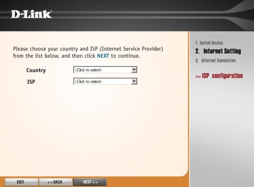

15. When the modem detects your broadband service, it will ask you for the Country and your Internet Service. Choose United Kingdom for
Country and Other for ISP.

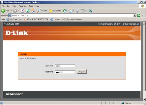

1. First connect your hardware following the above instructions. Open your web browser. In the Address line type in 192.168.1.1, then
press Enter.
websetup0

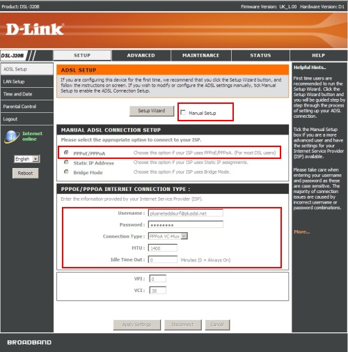

2. A login page will appear, enter the modem's administration username and password and click Log in. By default the details are:
  • Username: admin
  • Password: admin
websetup1
3. From the ADSL setup page you can choose either the Setup Wizard or Manual Setup. Tick Manual Setup.
websetup2
Manual ADSL connection Settings:
  • PPPoE/PPPoA
  • Username: Your broadband username
  • Password: Your broadband password
  • Connection Type: PPPoA VC-Mux
  • MTU: 1400
  • Idle Time Out: 0
  • VPI: 0
  • VCI: 38
Check your entered settings, then click Apply Settings.
