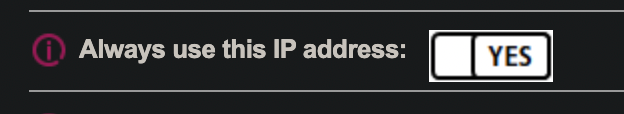

To be honest it's much easier to pin the ip address that the hub two has already issued.
Find the device in this list http://192.168.1.254/basic_-_my_devices.htm
Then select:
No manual settings and no restarts required.

This works for me:
1. Connect to hub using DHCP.
2. Go to the Advanced/My Network page.
3. Select the device.
4. Select Always Use this IP Address and Save.
5. Select the IP address, change it to your preferred address and Save.
I have tested it on an Ipad and it works. Note that you have to select always use this address first in order to open the option to set an address.
