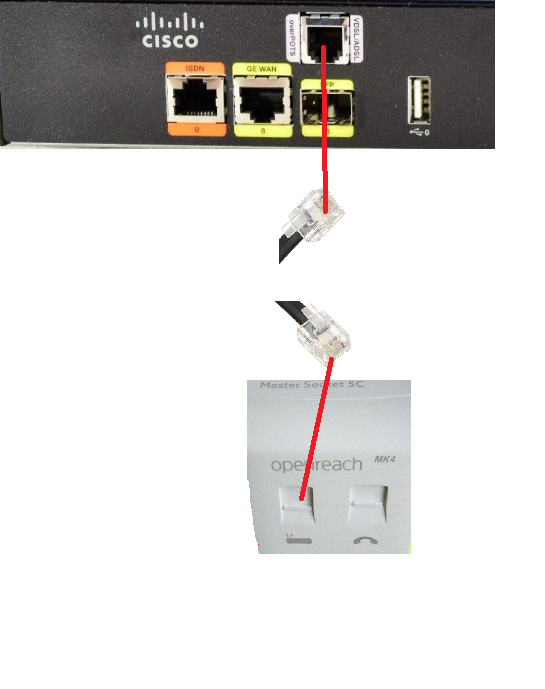

2. Connecting the Router up:
2.1 - Plug in your power adapter and power on the Router
2.2 - This guide assumes you are using a cisco 887VA, 897VA or another Cisco Router that has a VDSL/ADSL port on the back of the router, they look like this:
VDSL/ADSL POTS Port
2.3 - The DSL cable that Plusnet provide with your Broadband router plugs into the VDSL/ADSL over POTS port, the other end of the cable will then plug into your Telephone and Broadband Master socket connect these up, see image below:
VDSL Master socket connection

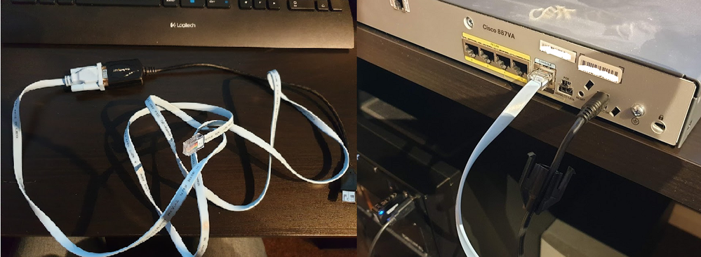

3.1 - Then you need to console into the router to be able to configure it to do this connect together the RS232 console cable and USB adapter, plug the console cables RJ45 connector into the Console port on your router and plug the USB port into your PC, see images in the link below:
Console connectivity
3.2 - Once you have the console cable connected to the router and your PC you need may need to allow the drivers for the USB adapter to install, once this is done go into device manager and look for Ports (COM & LPT) and then look for a USB to serial comm port adapter make a note of the COM number, in my case it's COM9, see image below:
COM Port Number

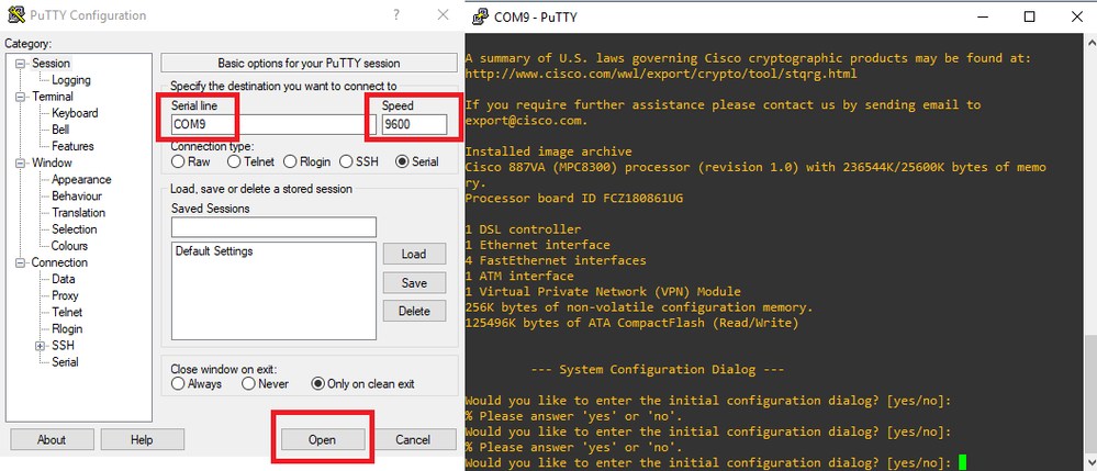

3.3 - Then download a Terminal program such as Putty (google this), open putty up and go to Serial and enter in your com port number, if your terminal program requires settings for serial the settings are below, once you have clicked open you should have a black screen with output from the Router (you may need to hit the enter key a few times) (see images in link below)
- Speed/Baud = 9600
- Data Bits = 8
- Stop bits = 1
- Parity = None
- Flow Control = XON/XOFF
Putty
3.4 - Now it's time to start configuring the router, you will more than likely be asked "Would you like to enter the initial configuration dialog?" always choose No for this.
The router will then do some more things and you will end up with a prompt that is displayed Router>
Type in enable and hit enter and then type in conf t and hit enter
You are now in the global configuration mode and can start to copy and paste in a template the prompt should look like this Router(config)#
