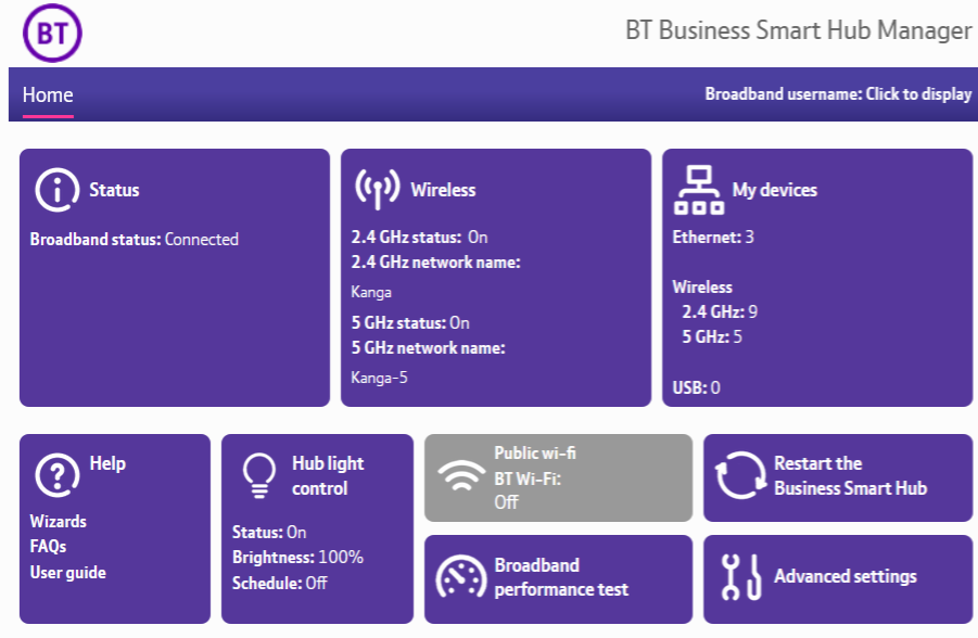

In my opinion a Business Smarthub 6 is the way to go. The public WiFi works differently in that it has the option to turn on open Public WiFi, that is, it is not password protected as used in Pubs etc. You have control over this. This is mine, the firmware was updated last month:
In terms of access control you can specify that device MAC addresses should always use the same DHCP address and control access times for each IP address as required.

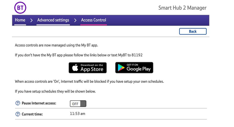

@Baldrick1  for info you can only use the BT mobile app  (Restricted to BT Customers) to apply access controls on the BT Smart Hub 2Screenshot 2020-04-18 at 11.53.30.pngScreenshot 2020-04-18 at 11.53.30.png
Posts: 14,488
Thanks: 7,397
Fixes: 473
@LifeonMars
Thanks, so another reason to get a Smarthub 6 whilst they are still around and cheap. I wonder if all these shenanigans are specifically geared to locking out Plusnet customers without directly upsetting those already using BT kit or just coincidental? One for the conspiracy theorists!

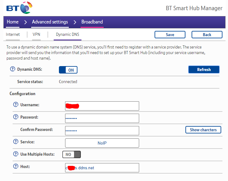

Now for my query, I joined PNet start of the year, and since doing so I have been using my old BT Smart Hub (V1 I think).
One thing I have been observing very lately in the logs (after checking a number of disconnects within a short time frame) is this
(ugh stupid forum cannot make a clear quote block without fiddling with a daft small html box).
13:29:34, 18 Apr.DDNS Status: error (the hostname c***s.ddns.net specified does not exist in this user account or is not in the service specified in the system parameter)
This happens and logs every 5 minutes. Anyone have any ideas as to what is going on ? Because I did not have this issue while on BT, and there is no logical reasoning why this should start with a change of ISP.
If I look on the Dynamic DNS page though it says connected
bobpullen
Posts: 17,123
Thanks: 5,411
Fixes: 330
@Mack have you tried logging into the No-IP website to check that the ddns.net domain is still active against your account? I know the free hostnames expire automatically after a while.
Mack
Posts: 33
Thanks: 3
Registered: ‎08-01-2020
@bobpullen Yeah I had already done that, but as a rule of thumb I always renew the day the email lands so it does not lapse.
