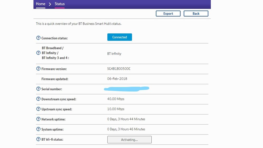

I have a business hub but do not have the option to turn public wifi off (see attached). I am hoping it comes when I get the firmware update that includes it.

Re: Smart Hub 6 Variants and Performance
updated overnight
now looks like @jordanc1230 post above with public wifi off button.
