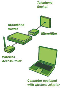

2. Connecting up a wireless hardware
Connecting up a wireless access point
The following steps are provided as a general guide, we advise you to use the documentation that comes with your hardware for more specific information. If you purchased your hardware from Plusnet, you can find hardware specific information on our Modem and router setup guide.
If you are planning to connect to your wireless router from all corners of the house, it's a good idea to try and locate it centrally. In most cases the wireless router will be placed close to your telephone master socket, to reduce the chance of broadband connection problems as a result of problems with your extension cabling.
a) Connect the microfilter to your telephone socket. You can get more help with this step by reading our Guide To Fitting Microfilters.
b) Connect the power supply cable to the wireless router and plug it into the power socket.
c) Using the Ethernet cable provided with the wireless router, connect the DLS socket of your wireless router the DSL socket of the microfilter.
d) You may need to attach the aerial to your wireless router. The best reception is often found by having the aerial position upwards.
e) Switch the wireless router on and confirm that the appropriate lights come on. See your hardware documentation for the specific details.
Your wireless router will be connected to your broadband service when the DLS light stops flashing. If the light doesn't come on, or doesn't stop flashing - check the Broadband Troubleshooting section for more help.
Next go to the Setting up your wireless network.
connecting with wireless access pointThe following steps are provided as a general guide, we advise you to use the documentation that comes with your hardware for more specific information.
a) If you need to setup your broadband router, follow the instructions that came with it, or check out our General Broadband Setup Guide.
b) Connect the power supply cable to your wireless access point and plug it into the power socket.
c) Using the Ethernet cable provided with the wireless access point, connect the network port of your wireless access point to a spare network port in your router or switch.
d) You may need to attach an aerial to your wireless router. The best reception is often found by having the aerial position upwards.
e) Make sure your wireless access point is switched on. See your hardware documentation for the specific details.
Most wireless access points have indicator lights that show if they have successfully connected to a network, and sometimes a light to indicate when data is being transferred. If the access point doesn't connect to your network. Repeat these instructions, check your cables and if possible plug the wireless access point into a different network port.
