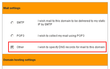

Then select the Mail Delivery method as "other" and then set up additional mail records for each domain using the "configure DNS records" button.
smtp_domain_setup
