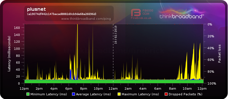

I notice a lot of irregularities, it will spike for no reason on random periods. I would understand if it was peak hours and the speed was throttled to some extent, but I get packet loss to Origin servers as well as an example or the mentioned POE problems at 2-3 am.
Im not sure if the BQM will help bellow

Thanks for the BQM, apart from the issues you’re experiencing while gaming do you have any issues with your broadband connection when for example browsing the web or streaming?
Are your devices also connecting over WiFi or wired directly to your router via an ethernet cable?
Finally when you notice the latency spikes is there anything on your network downloading or uploading?

Your connection seems to be solid (I'd ignore that the connection stops at 3am, that's just our reporting system not catching up at the moment to show your connection is still online).
There's no congestion seen on the VLAN:

I've also got in touch with our suppliers quality assurance team to check the VLAN out in more detail, and I've been advised that they're not seeing any issues either as their graphs show the usage below where they'd expect.
However they have identified a quieter VLAN so they've agreed to move you on to that, which should happen within 24-48 hours though sometimes overnight so I'll check back tomorrow.
Failing that I'd say the next step is arrange an engineer visit with you requesting that they do a "lift and shift" moving you to a different port at the cabinet which can quite often fix odd issues like the ones you're experiencing.

It looks like our suppliers quality assurance have dug into this in more detail and advised that they believe the problem to be related to interference as opposed to a VLAN issue so they haven't moved you to a different one.
Is there anything near your router which may be giving off electrical interference or anything going off on a timer?
