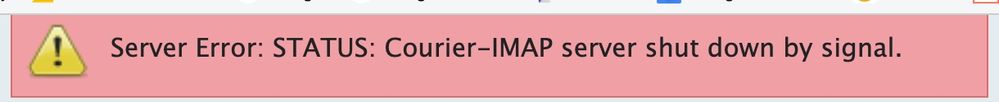

I got as far aschanging the values as suggestedin the solution.
Now all I get when trying to delete emails is either:
Server Error failed to send Fetch Command, or UID Copy Courier IMAP Server Shut Down by Signal.
This is immensely frustrating because the reason I'm trying to delete these (and several hundred emails) is to try and get round an Outlook Live email issue which won't allow me to delete emails from that system. Microsoft are investigating that apparently, but in the mean time they suggest we delete the emails from the 'host server' (ie Plusnet in my case) so that the emails don't get brought into the Outlook system.
Absolutely useless.
Plusnet, please sort out the issues I've highlighted with Webmail.
