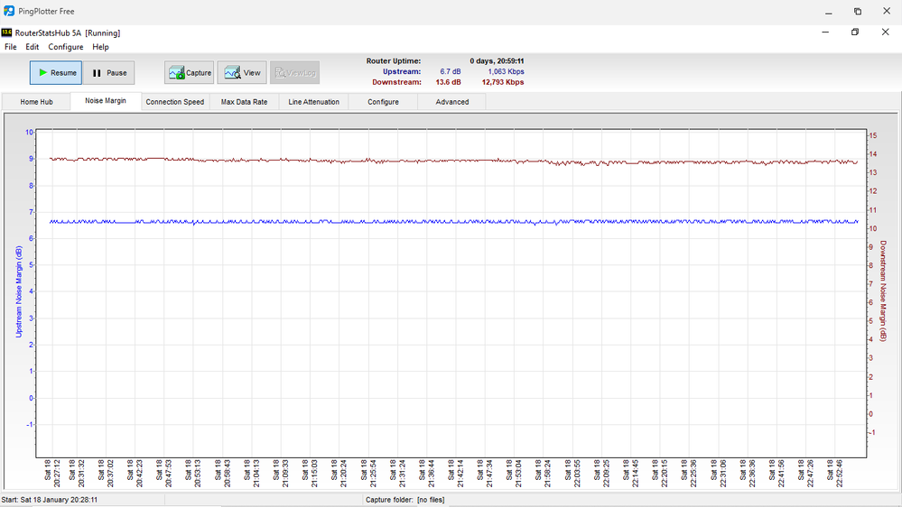

The Plusnet Hub One is a BTHH5a for which there’s a customised version of RouterStats … which delivers good quality data.
That Rx margin plot is utter nonsense - SNRM is typically less than 21dB (ideally 6dB) - the scale of the graph is not appropriate. More over where a SNRM plot is concerned, where variable, a higher value indicates a better state of affairs than a lower one.
The very old link in my sig to configuring router stats referenced a thread which has been archived and referred to the excellent sagem router.
The BTHH5a version needs little configuration beyond setting the sample interval to 10 seconds and the graphs to 720 plots. That delivers 2 hour intervals per graph and provides clear visibility of short duration noise spikes.

Thank you for the instructions, sorry i did the totally wrong program initially. This is what I have now for the past few hours on router stats
this looks relatively stable, however i am having a lot of packet loss right now.. so i am quite confused

Your Hub-One modem stats, and your noise margin plot, would suggest that there's not much wrong with the ADSL connection, and you probably don't have much (if any) noise related packet loss - just bursts of excessive latency where the ping replies take too long to return (showing as red stripes on PingPlotter).
So back to my original theory that something on your network is uploading at approximately 1Mbps and swamping your outgoing connection. You now need to isolate your internet so that ONLY your laptop is connected for monitoring purposes.

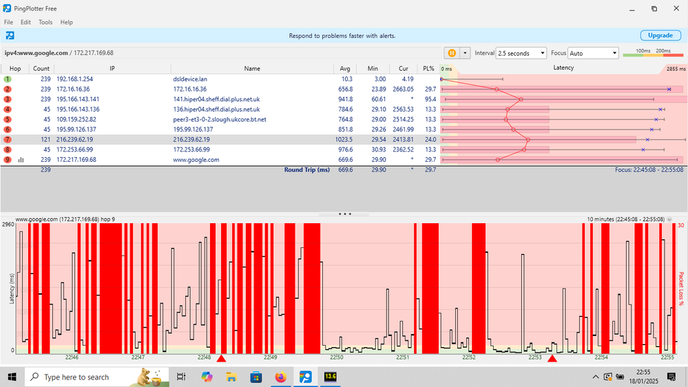

Yes I can try that, only my laptop is connected now to the hub and I am still getting the latency on pingplotter.
do you mean the resource monitor app?
I have that open and see the graphs but I do not know where to go from there to check if the network port is transmitting.

If you look at the last ping graph which is actually a trace route I see the average ping to the Hub is 10ms, that is not a good sign, mine is usually around 1ms even on a wireless connection.
For reliable connection testing pingplotter should be running on a wired device connected directly to the router or via switches to the router NOT via powerline adapters or wireless.
Do you have any device which streams data on your local network?

When you had your laptop using a wired connection to the Hub did you see have the same results as now with regards to packet loss.
A weak wireless signal reduces the speed of the connection between the wireless adapter and wireless access point in this case your Hub One.
The problem with detecting packet loss is that some devices in the path to the target might not respond to all ping requests, a missed ping request would be detected as a dropped packet. End to End ping test is really what would be of concern.
Good spot Dan !
Here's mine -
> ping 192.168.2.1
64 bytes from 192.168.2.1: icmp_seq=1 ttl=64 time=0.132 ms
64 bytes from 192.168.2.1: icmp_seq=2 ttl=64 time=0.166 ms
64 bytes from 192.168.2.1: icmp_seq=3 ttl=64 time=0.167 ms
64 bytes from 192.168.2.1: icmp_seq=4 ttl=64 time=0.132 ms
64 bytes from 192.168.2.1: icmp_seq=5 ttl=64 time=0.131 ms

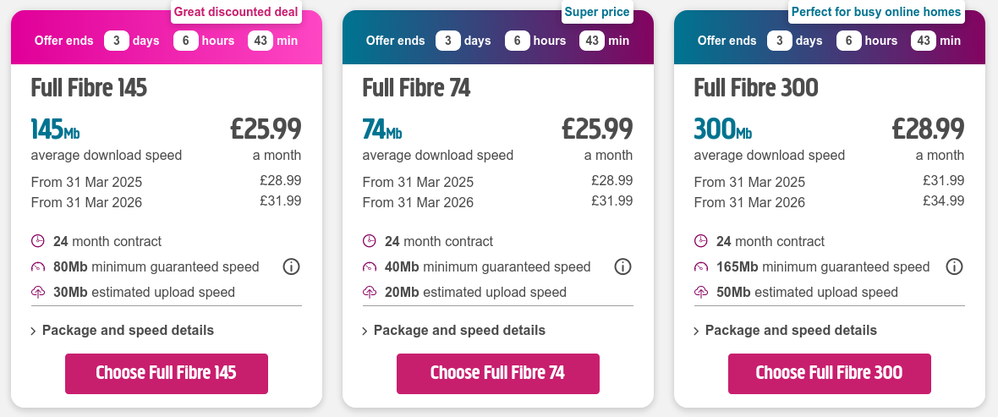

@Albut17 wrote:
Full fibre is available here but I am in contract on asdl until july.
@Albut17   That raises four questions -
1)   Is your available "Full Fibre" from BT Openreach, or is it a third party AltNet provider ?
2)   Do you currently use your landline telephone ?
3)   Are you aware of the Openreach conversion of analogue landlines to digital telephones, due to occur during 2025 ?.
4)   Do you intend to keep using your landline phone after the analogue PSTN switch-off ?
[edit] my post overlapped with some of the same points made by Dan, but would still be helpful if @Albut17  answered my questions

@Albut17  upgrading to Full Fibre, sooner rather than later, solves several problems -
  • You wouldn't need to 'cripple' your Apple devices performance just to work with your ADSL broadband
  • Your video calls would have more than enough bandwidth to eliminate all buffering problems
  • Your line latency would drop from your current best of around 30ms down to single digit milliseconds
Attempting to convert your landline phone to VoIP on your ADSL (as it is) would be nearly impossible, whereas using FTTP will be perfect.  Bear in mind that unless you act soon, Plusnet will be forced (by BT Openreach) to remove the telephone number from your account (before end of 2025), which would leave you with a problem as ADSL minus phone number becomes SOADSL - which Plusnet don't support,  so you would also lose your internet.
Don't waste any more time trying to get ADSL working, get upgrading ADSL to FTTP, then PSTN landline to VoIP.
My advice -
1)  Initially upgrade to one of Plusnet's slower FTTP speed options - you can easily upgrade speed tiers later, but downgrading is discouraged and expensive.
2)  Upgrading from ADSL to FTTP will put your landline phone number in to 30 day quarantine, during which you then migrate the number to a VoIP phone supplier (such as A&A)
3)  DO NOT attempt to migrate the phone number to VoIP before your FTTP is fully up and running, otherwise you risk Plusnet account closure !
GOOD LUCK !  👍
