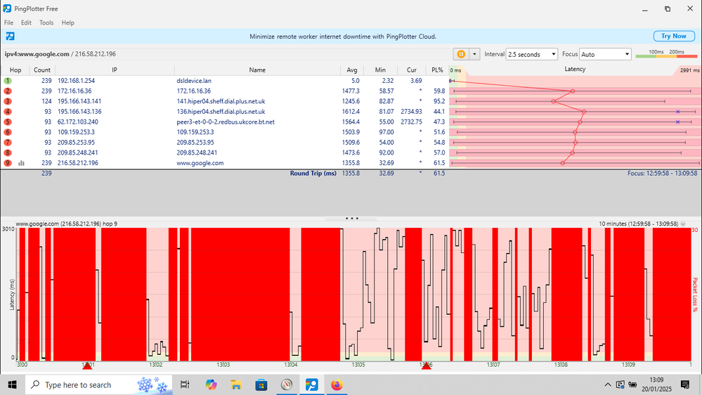

This definitely needs to happen but for now today the situation is worse than ever. I took 30 mins to update my grocery order earlier and get my payment to go through. I have turned off all of my apple devices and am getting huge patches of 100% packet loss up to a minute in length. The hub 2 has not arrived yet so I am just going to put my old sagemcom or thompson router back on as im at the end of my rope from this.

@Albut17 This is not an area  I am an expert in, but something is horribly wrong right at the start of you 'journey' - 5/10ms for your hub to respond is ridiculous, and the 'round trip' times are scary. I would try the 'newer' of your old routers and see if you get any improvement. I assume that now you have a dual socket master, you have dispensed with the 'dangly' filter. How old is the Hub1?

The hub 1 would be a few years old but I never used it until this problem started a month ago. I was using the sagemcom router until then, when I called PN they suggested I plugged in the Hub 1.
Yes I had a duel socket master installed last week.

Right, so I'm guessing the Hub1 has fallen off the management platform, has really old firmware and basically is not set up optimally, although that shouldn't, AFAIK, cause that horrible response time and packet loss.
I assume the Hub is plugged direct into the DSL socket on the master, with no intermediate wiring?
Have you been advised when to expect the Hub2? When you get it, plug it in using the cables etc supplied with it (not your old ones), and see if it makes any improvement.
