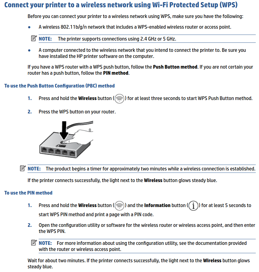

I see on the screenshot in Reply #10  that the Hub Two has a [Start WPS] button shown.
From the printer's user guide - http://h10032.www1.hp.com/ctg/Manual/c07043347.pdf   (page 22)
here are the instructions for connecting using WPS (avoiding typing any passwords or other missteps)

OMG it has worked. THANK YOU so much tp everyone who helped me. what a fantastic group of people.
