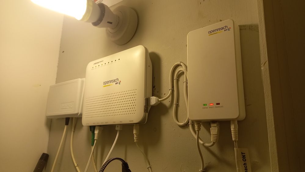

The ONT looks like an older unit than I had in my last property and is pictured. It is located under the stairs where there are only two power sockets installed. Once socket is used for the ONT unit and the other I have plugged in my Archer C6.

The ONT is indeed an older unit. If it's the same as mine you can theoretically have more than one incoming fibre connection if you can find someone to provide it. More to the point, it has a battery backup unit for the ONT. It's currently showing a fault, which may be nothing more than the internal batteries needing replacement.

The following video shows how to change the BBU batteries. Although it looks different, once the ONT is opened up it's got the same BBU unit. If you put power backup in place for the router you'd at least have WiFi for about an hour during a power cut.
