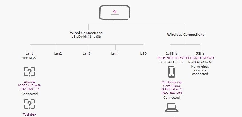

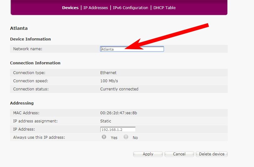

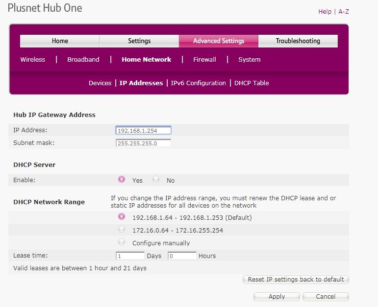

@VileReynard wrote:
The Hub one is rubbish.
.Nor can you specify a router address.
you have no control over DHCP.
You can't even associate a MAC address with a PC name.
What the hell are you banging on about?
screenshot_658screenshot_658
Can't associate mac addresses with names? - Whats this then?:
screenshot_662screenshot_662
It may not be the most reliable device but for features it knocks the socks off my old Cisco ADSL router. I think you need to stop spouting your mouth off foxy. You're slagging off plusnets pretty decent device for no good reason.
Sure the lack of custom DNS is a problem but you turn off the hubone dhcp and run your own DNS on a raspi and run a dhcp server alongside it to hand out IP addresses for devices - the dhcp packets carrying the ip addresses of nameservers to use. If you have a 24/7 windows box you can do the same there though free software versions are limited..but you could virtualise a linux distro and still do it.
