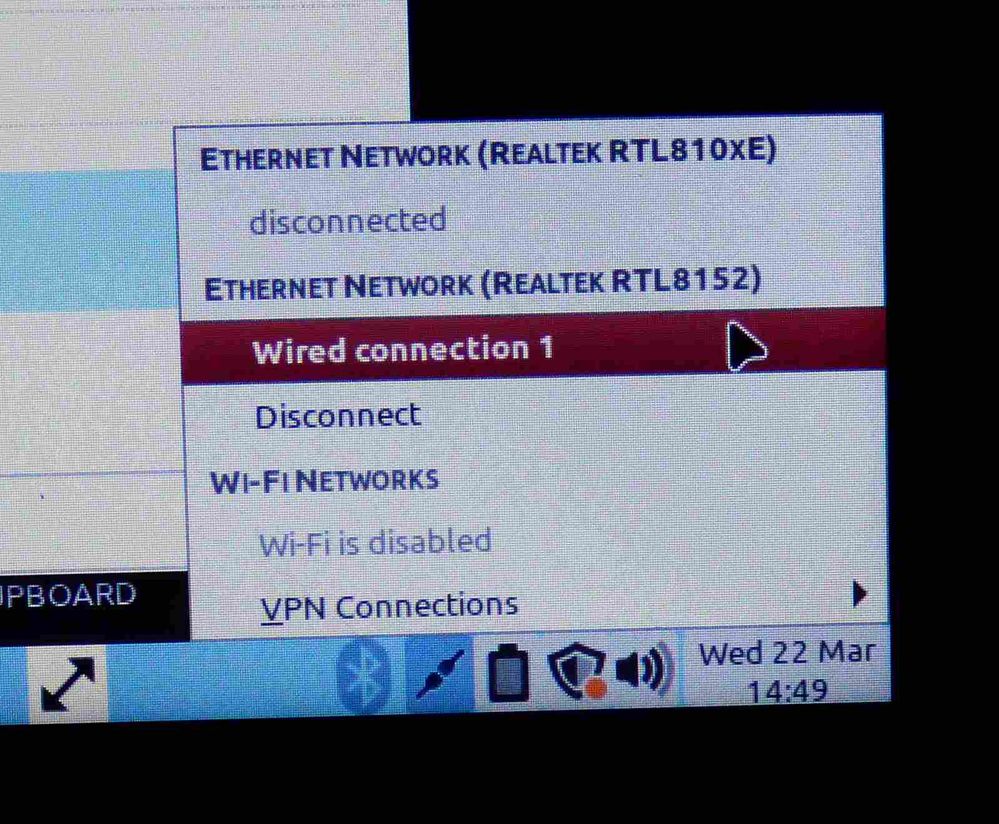

Thank you for your combined efforts... I have been in contact with Realtek in Taiwan... and they suggested I download a driver from their linky, which was a specific Linux driver... which I did, and I installed it,.. R8101, which brought us back to where it showed "connected"  but could not access the internet properly,
Since then, I have received the USB to RJ45 cable/dongle, suggrested by @Dan_the_Van   plugged it in, connected the ethernet cable, and instant "Wired Connection".
Interestingly both the above show the driver to be r8152... which I never installed, so it must be something on the actual dongle with that driver installed.
@shutter in general all the available drivers are part of the Linux kernel. When the system boots it detects the connected hardware and if it recognizes it, loads the appropriate driver for that hardware.
In the case of your USB dongle , it detected that it required the r8152 driver and loaded it.
