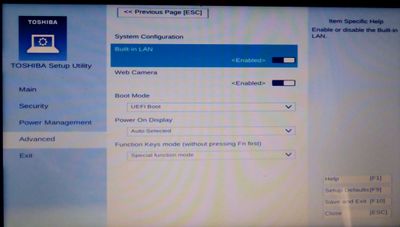

I have been through the BIOS settings to make sure that LAN is enabled ( has always been, as far as I know ! ) .
I have disabled WIFI  but kept Networking enabled

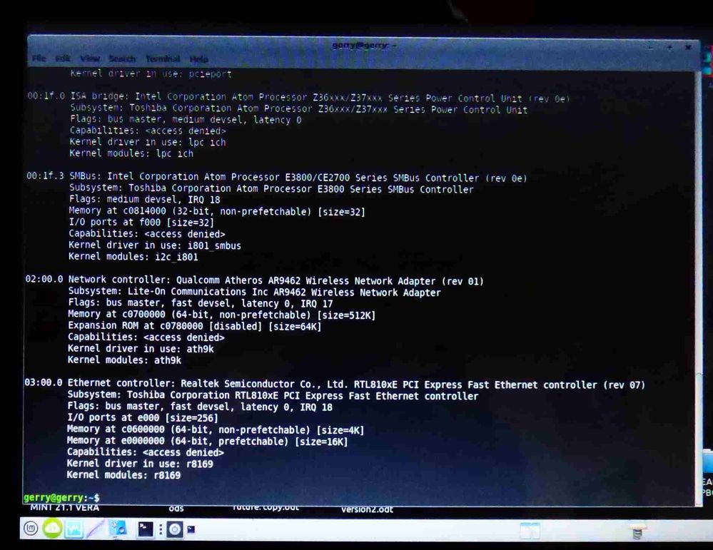

@shutter  run '
sudo lspci -v
from a terminal window
Look for the ethernet controller and see if its loaded a driver

@MisterW  Thankyou.
Here is a photo of the Network and Ethernet sections

There's conflicting information out there as to whether r8169 is the correct driver for that nic or whether it should be r8101 see https://forums.linuxmint.com/viewtopic.php?t=385186 for example.
I think you need to do some research

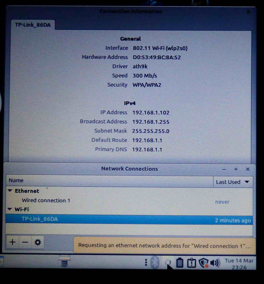

After some several attempts to follow the bits and pieces of the linky`s  ( and your advice in PM`s).. I have had some PARTIAL SUCCESS.
The 8101 driver is now installed... and the socket accepts that a cable is inserted, and the driver seems to be searching for something. as where the connection icon is on the (bottom task area) panel, the two plugs have been replaced by a curly swirly icon, indicating that it is searching, Also there is a pop up message saying requesting ethernet address
After about 1 minute or so, it stops for a second only, and shows the two plugs, then disappears and resumes searching. Also, a message appears at the top of the screen saying "Disconnected".
Is there a way to manually enter an ethernet address for "Wired Connection 1".

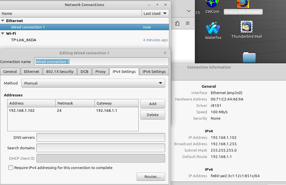

@MisterW  I have done a MANUAL insert of the IP address
I put 255.255.255.0 in the Net Mask Column,....but it has changed to 24 for some reason! don`t know if I am doing the right thing.
Wondering about three things now.
1. The driver on the Toshiba ( with the problem) is showing as the "new" driver r8101  but the driver on the ASUS is showing  < iwlwifi >
2. in the above pic there is a small box at the bottom which says "Require IPV4 addressing for this connection to complete"
would this be the "something else" that you mentioned?   regarding not being found by DHCP.

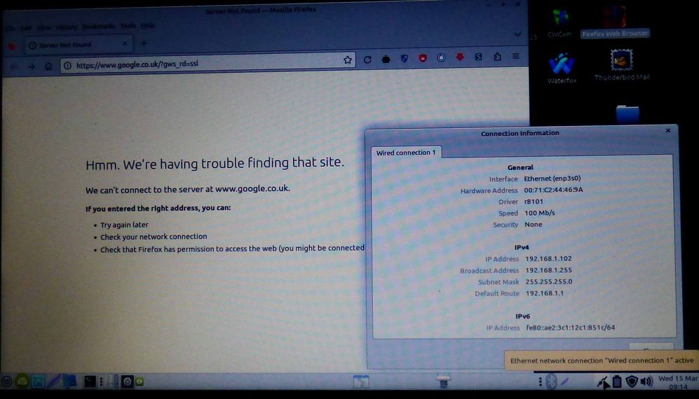

3.  with the Manual insert the message showing on the icon as connected, is as follows
But I get a message Server Not Found...when I try to search with Google.
Also.. despite the message saying it is Active.           ... If I click on the "bold type"   Wired Connection 1  in the listings  I get a quick flash of the "connected"  and then the "disconnected" mesages at top right corner of the screen...
so it appears that, although the "line" is "active".. there is still the problem of actually connecting to the internet via the router.

Looks like neither the r8101 or the r8169 driver really like that nic.
I suspect you're stuck with just wireless on that laptop
Nb the iwlwifi you refer on the asus is for the wireless card not the wired one

@shutter
You can not use the same IP Address as the wifi network it must be unique, try something else like 192.168.1.50 which is below the DHCP assignment range.
24 bit mask is 255.255.255.0
Dan

Also, shouldn't the "Gateway" be 192.168.1.254 - ie the router's IP address? (It says 192.168.1.1 in that picture)

@Dan_the_Van  Have deleted the previous address... and inserted 192.198.1.50   which remains RED also the 192.168.1.1 ( router) remains RED.. is this correct... or is it telling you (me) something else... as I can`t "Save" the entry (greyed out)
@Anonymous  Changed to .254  and still RED and still no "save"
Correction to above.... error on the 192.168.1.1 insert  (Missed out a dot ! ) now it is correct and showing GREEN
Also error in the first one... ( was two dot ! )  must get these glasses fixed
Connection/Disconnection problem as detailed in previous remains the same.
