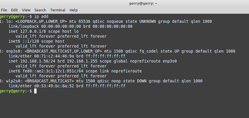

@Dan_the_Van  ok... Thanks...  have done an edit to my response  !.. mucho mistakes !.
here is the result of ip add
Interestingly..... I did a reboot, prior to the above.... and on start up, got the message  "you are now connected to Wired Connection 1...   ( as would be expected)
but when I tried to browser search fo Plusnet.... got the Server Not Found message ... and clicking on the listings "wired connection 1" resulted in the connected/disconnected   as before.

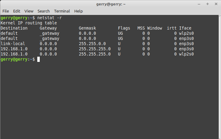

netstat -r in a cli will detail the default gateway.
Can you ping anything on your network, like your laptop or the TP-Link router?

OK @Dan_the_Van   back online on main ASUS again.... Toshiba is also running but still not properly connected. so I have to copy things from and to.
here is the result of your request for netstat -r
Interesting to see 192.168.1.0
As an experiment.. I changed the previous manual from .50 to .0 to see if that would make a permanent connection on the wired connection...but, alas, no. still the same, instant connected/disconnected messages
Rebooted after changing the manual setting... now CWCOM is showing my IP address as 192.168.1.102 ( on the Toshiba) (Showing 192.168.1.111 on the ASUS)
Haven`t got a clue how to "ping" anything ! or anyone ! .
The router is showing as enp3s0 for the Toshiba.....but is showing as enp3s0f1 for the ASUS

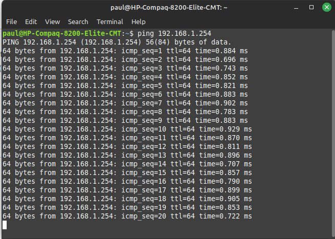

"Haven`t got a clue how to "ping" anything ! or anyone ! ."
In the Linux Mint Terminal, type ping (space) then the IP address of the device that you want to "ping", then return.
For example this is what I see when I ping my Plusnet Hub2: (It keeps going until you close the Terminal).

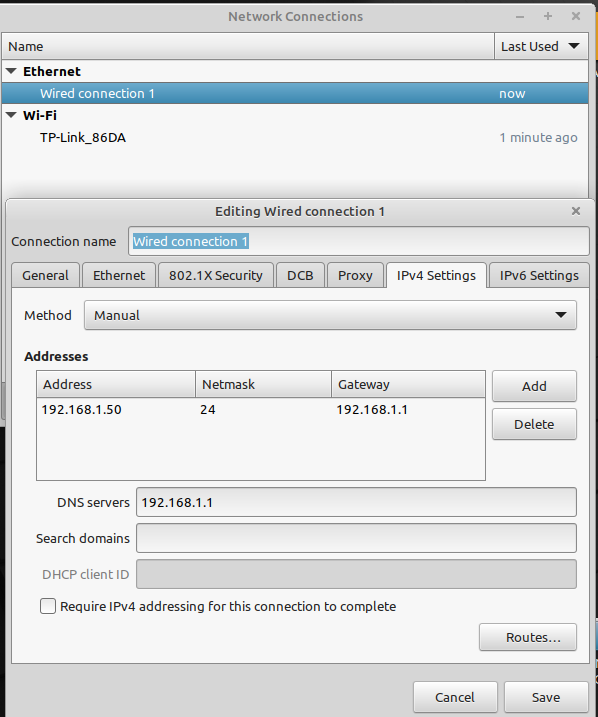

We need to rewind back a bit to when you set the laptop IP Address, suggest you use these settings. I do not think a DNS Address was added.
IP Address - 192.168.1.50
Mask - 24, which is 255.255.255.0
Gateway - 192.168.1.1
DNS - 192.168.1.1
Also, it could be the laptop will only allow for a active wireless or wired connection, but maybe not both at the same time. So I would disable the wireless interface while setting up the wired interface.
Let us know how you get on.

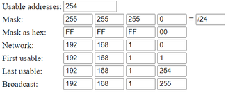

Note:-
A network consists of a range of IP Address, this is dependant on the network mask being used, for most domestic networks a class C network is employed.
For your LAN you get the following
Devices can be allocated IP Addresses manually or automatically via DHCP. DHCP is the preferred method.
The router has a DHCP server and it is here you setup the DHCP pool. (The range of IP that are allocated by the DHCP server)
Hope that makes sense

When trying to connect via the "Wired Connection 1"   I do disable the wifi, just to be sure that any positive connection can onlly be by the wired connection.
Have reverted to your suggestions on the IP address and hope that I have put the DNS ip in the correct place
Done a reboot,... still the same  although it shows the two cable plugs as "connected" and , indeed it shows the Wired Connection 1  as connected... still not able to access the internet through Google search.

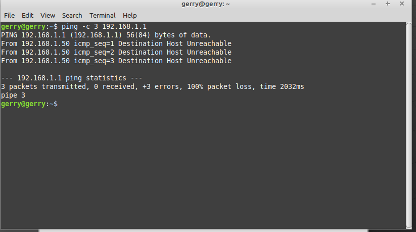

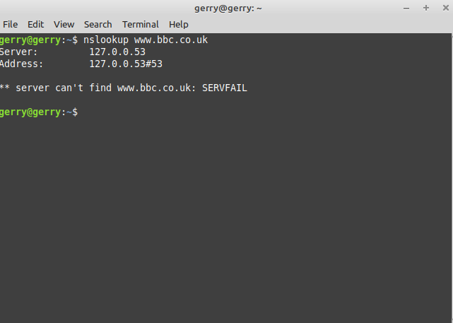

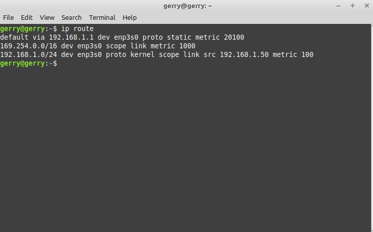

Can you confirm the following using a terminal on the Tosh with a wired connection to your router
1) ip -4 add
2) ip route
3) ping -c 3 192.168.1.1
4) nslookup www.bbc.co.uk
Hopefully the output from all four commands should fit in the same terminal window
2.
3.
4.

192.168.1.50 "Destination host unreachable" means the ping command is not getting a reply from your router/defaultgateway
nslookup fails for the same reason, you laptop can not see the router.

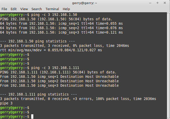

What if you ping the other laptop from the Tosh, do you get "Destination host unreachable". If you do this might suggest there is an issue with the wired network interface.
So please try these commands using a wired connection on the Tosh.
1) ping -c 3 192.168.1.50
2) ping -c 3 <ip address of your other laptop>
Does the TP-Link router show the Tosh as a connected on the status page for wired devices?

@Dan_the_Van  Going backwards on your list !
No.. the Toshiba does not show as a "wired connection" ont eh TP Link router
Ping result from the Toshiba to the Asus    see message 24 above.
Pings as per pic below...

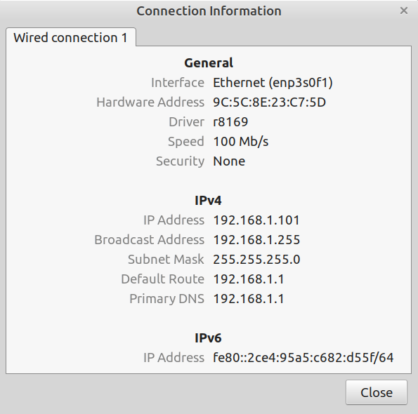

OK @Dan_the_Van
Disabled wifi on the ASUS... connected the same cable to the ASUS...  got this
Interesting to note the driver is the r8169 on the above Connection Information

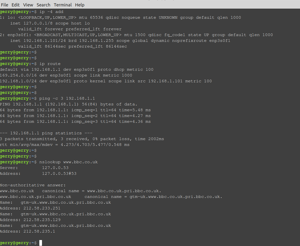

Here are the pings as requested.
