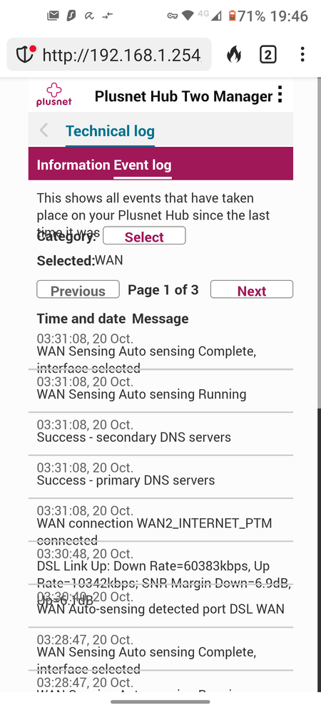

@Broadband These drops are too close together for my liking.  Is your Hub connected directly into the master socket/have you any extension wiring (that you know of)?
For clarity, do you only have a mobile phone - the display is less than helpful?

I'm uploading from a mobile, I was with plusnet anyway just taken a new deal. Because I was having WiFi issues I had plugged my old router back in so some are my doing, Think the hub 2 has been plugged in and left alone since last Thursday evening. Do you suspect the line has a fault ? It's plugged in and the master socket and extension has been disconnected

I'm aware you are uploading from a mobile, but I asked if you have a desktop/laptop  - uploads from them are much easier to read.
I suspect there is a fault somewhere on the OpenReach network, but I could be wrong.

The connection seems ok but I don't really understand what the logs are saying, I will try and use daughters laptop when shes in and upload from that thank you

With respect, you don't need to understand the logs, but we need to see them clearly.

Last comment for tonight - without going back over this topic, I think your speeds/SNR figures are reasonable, what isn't reasonable -  IMO - is the frequency of DSL drops/disconnections.

I have managed to download the WAN log, it has dropped a few times but speed has Increased so assume it does this to tedt that the can handle these speeds and be stable. If they look ok or not please let me know thank you

@Broadband That is looking better, although I am a little concerned that your downstream SNR is very low for a previously not very stable line.
I suggest you keep a close eye on your performance for a few days, as I suspect you may have further xDSL drops/resyncs with such low figures - but I could be wrong - hopefully.

A quick view of the attached log file, all the link downs occur between 00:00 to 03:30 time frame.
Entries before 20 Oct to me look like Hub restarts as there are no DSL link down messages.
There have been six DSL Link Down, each time the speed increases with a change of downstream SNR
First message
01:54:18, 20 Oct. DSL Link Down: duration was 29212 seconds
01:56:32, 20 Oct. DSL Link Up: Down Rate=60043kbps, Up Rate=10174kbps; SNR Margin Down=7.1dB, Up=6.1dB
Last message
00:26:22, 02 Nov. DSL Link Down: duration was 252290 seconds
00:39:29, 02 Nov. DSL Link Up: Down Rate=72688kbps, Up Rate=11047kbps; SNR Margin Down=3.3dB, Up=6.1dB
Normally a DLM resync takes about 2 minutes but the above looks to be a bit more lasting over 10 minutes, maybe maintenance work?
As @jab1 says the downstream SNR margin is 3.3dB which is low, time will tell if everything stays stable.
