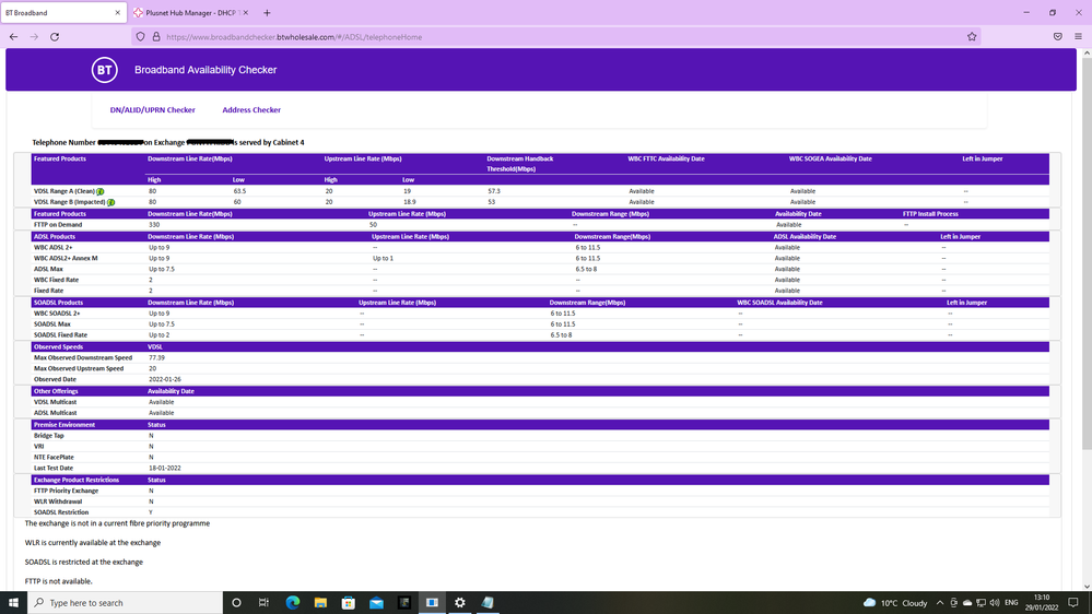

Re: Issues with Plusnet router
Here is the screenshot of the BT Broadband diagnostic.

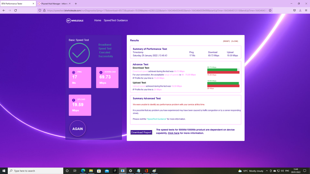

Here is the speed test.
Thanks - that shows you have good speed to your Master Socket, but the rest of the requested data will paint a fuller picture - I'll await that and have a look after lunch.

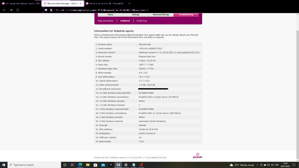

Here is additonal report and the hub one helpdesk report.
OK, @Pollyanna29 To be honest, I can see nothing in any of those reports which are of any significance, although the two BT speed tests did show a marked difference - sadly that can happen, even with this 'improved' version, so is not something I would focus on.
