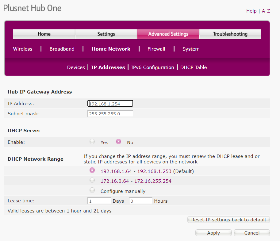

On the Hub One I have disabled Wireless and DHCP leaving the IP Address of the Hub One set to 192.168.1.254.

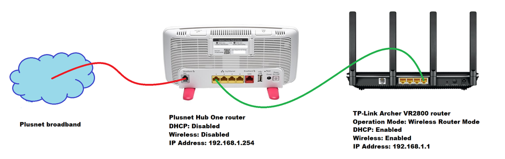

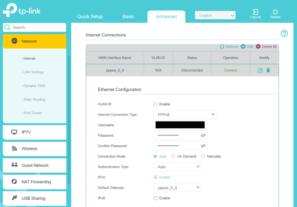

I am hoping someone can help me. I have tried to configure my home setup in the same way as Dan_the_Van has described here, however I cannot get my TP-Link Archer VR2800 to receive internet from my Plusnet Hub One.
My current setup is as follows (FROM: Hub One LAN port 1 TO: TP-Link LAN port 4/WAN):
As can be seen here, my Hub One router is set to IP Address 192.168.1.254, and DCHP is disabled on the device:

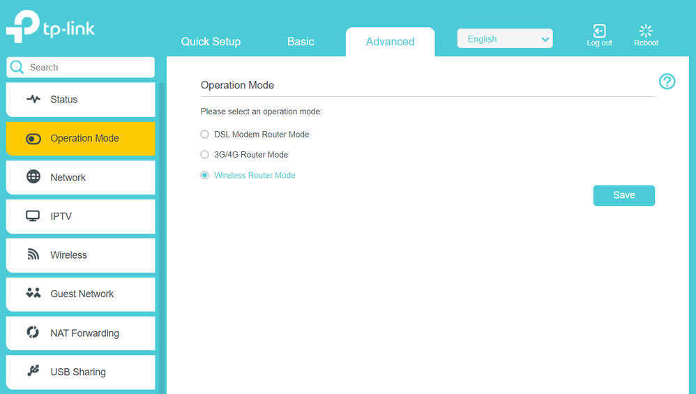

As can be seen here, I have set my TP-Link router to be on the Operation Mode "Wireless Router Mode":
As can be seen here, I have set my TP-Link IP Address 192.168.1.1, and DCHP is enabled and configured in range 192.168.1.2 to 192.168.1.200. Furthermore the default gateway is set to be 192.168.1.254 (the Hub One router's IP):
As can be seen here, I have set the Internet connection details to be PPPoE and entered my Plusnet account credentials for login:

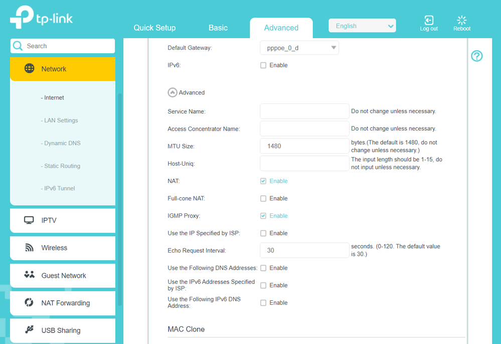

There are also some advanced settings on the Internet Connections setup page, however I have not altered these:

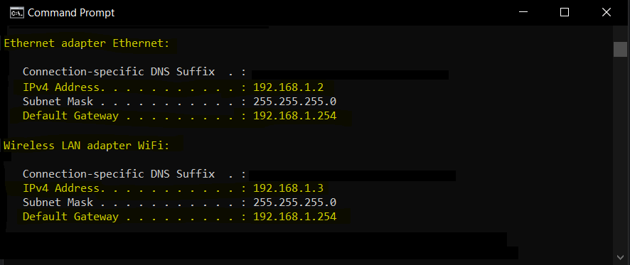

As can be here from ipconfig details, when I connect to the TP-Link router either over an ethernet or Wi-Fi connection, it is correctly assigning IP addresses, and the correct gateway IP of 192.168.1.254 is being set:

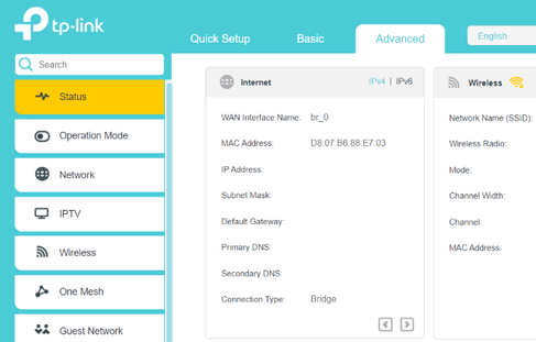

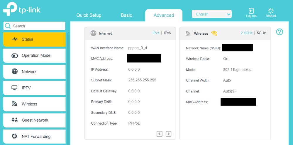

However, after multiple attempts at restarts of both devices, the TP-Link router refuses to see the internet connection, as can be seen here, where the default gateway and possibly some of the other internet settings are not being set for the WAN connection:
It seems to me like I have followed the instructions Dan_the_Van provided in their post from 30-05-2021, however the one part I am not sure of is the Internet connection details on the TP-Link. The Hub One router is successfully connected to the internet in the above setup, however I am not sure that I should be providing the PPPoE details on TP-Link router, as the Hub One is already using these details to access the Plusnet broadband connection. I have also tried using 'Dynamic IP' in place of PPPoE for the internet connection details on the TP-Link router, however this does not connect either. 😞
If anyone has any ideas for why this is working, I would be really grateful for the information.🙂👍

@sagesolar in your configuration, the tplink will not have an internet connection via its,WAN. Having said that, it doesn't need one! Any device connecting to the tplink using DHCP is being told that the hub one (192.168.1.254) is the default gateway ( route to the internet). So any internet traffic will be sent to the hub one which does have an internet connection

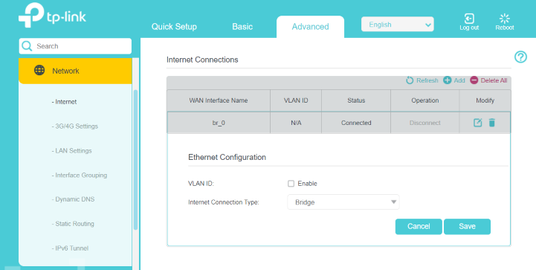

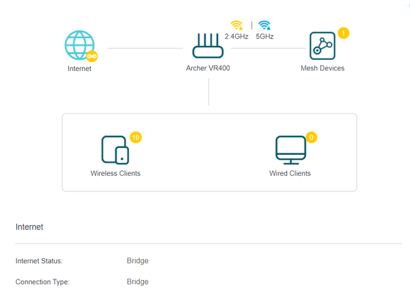

Hi @sagesolar
I am using 'Bridge Mode'
This removes the need for the internet login details. The connection from TP-Link uses LAN4 to any HubOne port. The TP-Link has a static IP address.

sagesolar
Posts: 6
Registered: ‎16-05-2019
Re: Hub One as a modem only
@Dan_the_Van Thank you 🙏, I just factory reset my TP-Link and then configured it as your/my original posts, and then set the internet connection type to be 'Bridge', and you suggested it is now working!
It would appear the key thing is to first ensure that:
  • DHCP on the Hub One ruter is disabled, and
  • DHCP on the 3rd party router (TP-Link in my case) is enabled and configured similar to your original description, and
  • The 3rd party router is pointing at the Hub One IP address as the gateway
prior to setting the 3rd party router to 'Bridge' mode, otherwise as I found out from my prior attempts, the 3rd party router will be unreachable.
Hopefully this is a help to others wanting to configure their home network setup in a similar way.
