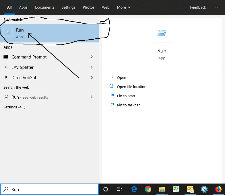

Plan B, This works on my Smarthub so should work:
1.Plug the memory in to your router
2. Log into your Router
3. Enter Run in the Search field in the bottom left hand corner of your Windows desktop
4. Select App
5. Enter \\192.168.1.254
6. Explorer Window opens showing Shared Disk
7. Right click Shared Disk and select Map Network Drive
8. Select a Drive Letter or leave on Z:. The Folder should already be set to \\192.168.1.254
9. Select Finish
10. The new drive appears in Explorer.

Windows cannot find 'App'.
Regardless, when I open the address within explorer it brings me to the Hub One credentials.
If I browse drives in explorer, there are no additional drive options so cannot 'Map' it.

@paulscarbs wrote:
Hi, thanks for sticking with this.
