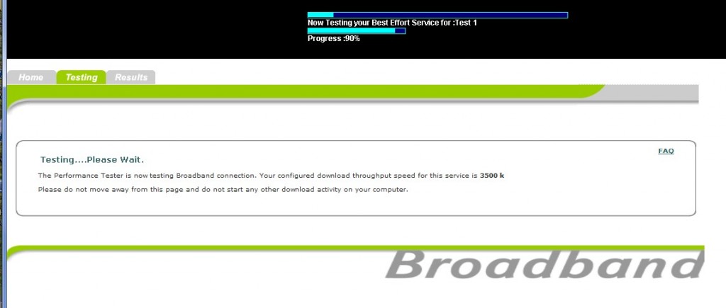

Step 3
Clicking on Go again will take you to the processing screen where you should see something like this
tester-3rd-page1
