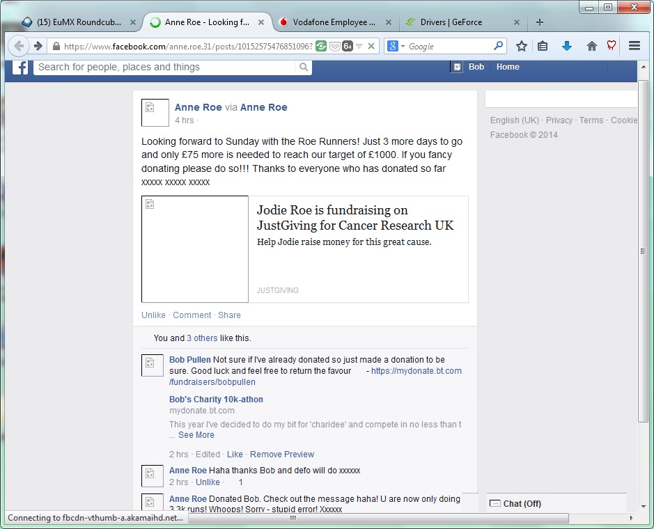

Anyone else having problems with Facebook images again?
java.com is OK, Facebook just seems a bit iffy from my desktop Huh
