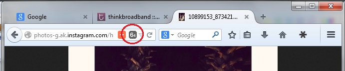

Try http://photos-g.ak.instagram.com/hphotos-ak-xaf1/t51.2885-15/10899153_873421292713054_1539817145_n.j...
The images are loading (eventually), but they are taking forever:
I'm on pcl-bng02 - if I disable v6, then I have no issues with any CDN hosted images.

I put
photos-g.ak.instagram.com       2a02:26f0:c8::17c0:a2e1
in my hosts file as then able to access the image in Firefox via v6. I'm on ptw-ag03

it loaded here but for some reason firefox is loading it over ipv4, suggesting the ipv6 ip had an issue.

When I first tried it loaded over IPv4 so I added the entry to hosts to force IPv6.

From what I can tell, it loaded over IPv6 for me without any hosts file trickery:
