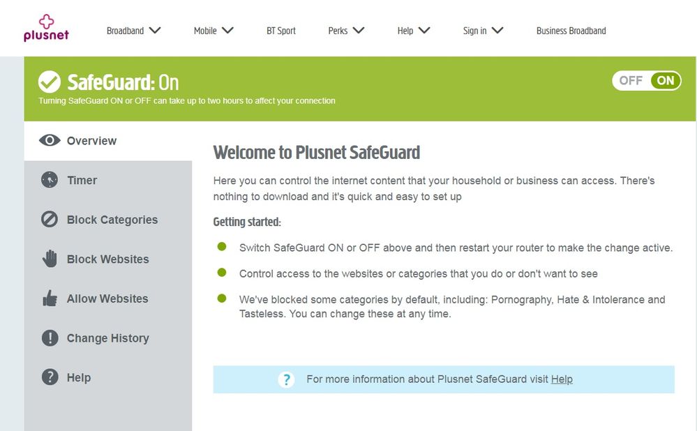

Hi JonoH,
Just checked...still the same for me.
Should be parts of 3 screenshots all taken at 13:00 today attached.
All well edited (I hope) !!
P
Adult site is accessibleAdult site is accessible
DNS on my routerDNS on my routerMy Safeguard is 'On'My Safeguard is 'On'

I've had a look into this for you @Percy2 and can you confirm the DNS servers are set to the following?
To set Plusnet Safeguard DNS server addresses
Primary 213.120.234.42
Secondary 213.120.234.42
If that's the case, could you switch Safeguard off, reboot router, back on and then reboot router again? Assuming that the sites you want to block are selected as to be blocked, let me know if they aren't blocked after 2 hours.

When I do that I get an error (rather than a block) but that's to do HTTPS and the content is still unavailable (and that's what matters).
@Gandalf The SS above shows that it is indeed set correctly.
