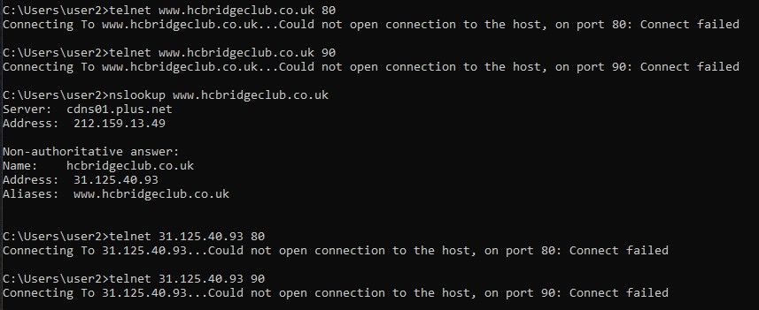

Re: Fixed IP address not responding
Two screen shots using nslookup and telnet (to target ports to determine the end-to-end three-way handshake is working)
And showing some DNS oddities?

greygit1
Posts: 411
Thanks: 57
Registered: ‎26-06-2023
Possibly. Possibly not.
telnet aforementionedwebsite 90
no reponse
telnet aforementionedwebsite 80
HTTP/1.1 400 Bad Request
Server: openresty
Date: Sat, 14 Oct 2023 23:52:25 GMT
Content-Type: text/html
Content-Length: 154
Connection: close
<html>
<head><title>400 Bad Request</title></head>
<body>
<center><h1>400 Bad Request</h1></center>
<hr><center>openresty</center>
</body>
</html>
Connection to host lost.
(Webbrowser connection to port 80 connects but displays nothing)

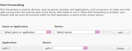

Posts: 5,004
Thanks: 3,313
@bryanuk wrote:
port forward on router
The screen shot on this post just shows the creation of the port forward ruled named as "U3Abridge" with inbound port 90 mapped to port 100.
Have you applied the rule to the target device?
For you Application would be U3Abridge; device would the hostname of the server.
Reminder, Hub One does not respond to ICMP (ping) and can not be enabled, unlike the Hub 2 which can be.
On the server  can you see it's IP port 100 in state LISTEN for connections using  netstat -ant command in terminal window

I have a third party router using Google DNS servers (also on a fixed IP address) - maybe this has some bearing on your problem?
Posts: 29,343
Thanks: 13,469
Fixes: 251
I doubt that connections are going nowhere near your Plusnet fixed IP address.
The domain name hcbridgeclub.co.uk managed by Go Daddy points to 3.33.130.190 and 15.197.148.33 which are both Amazon Technologies Inc platforms - that is NOT PLUSNET's IP addresses.
I suggest that you have been looking in the wrong direction: Why is Go Daddy not pointing your domain name to your Plusnet fixed IP address?
bryanuk
Posts: 30
Registered: ‎14-10-2023
Hi,
Yes the target device is looking at port 100 to divert to the web page index file.
If I connect locally to port 100 on the NAS, the wen p[age loads ok.
This morning I have run a 'canyouseeme.org test on 31.125.40.93 on ports 80,90, 100 and all report closed.  The router is not letting anything through.  I had the Router firewall switched off at the time.
I just dont understand why the ports are suddenly closed.
bryanuk
Posts: 30
i,
I think that is the A list entries in the Go Daddy config.  I have now deleted them, however, after a long conversation with Godaddy, in which i got nowhere, i reinstated the config that has worked for the last 2 years, mainly that I use the forwarding option in godaddy.
This is set to forward to http://31.125.40.93:90
I used this (on advice from godady a long time ago because in  A list you cannot put a port number to be addressed.
I hope I am making sense as this is not my area of expertise!
