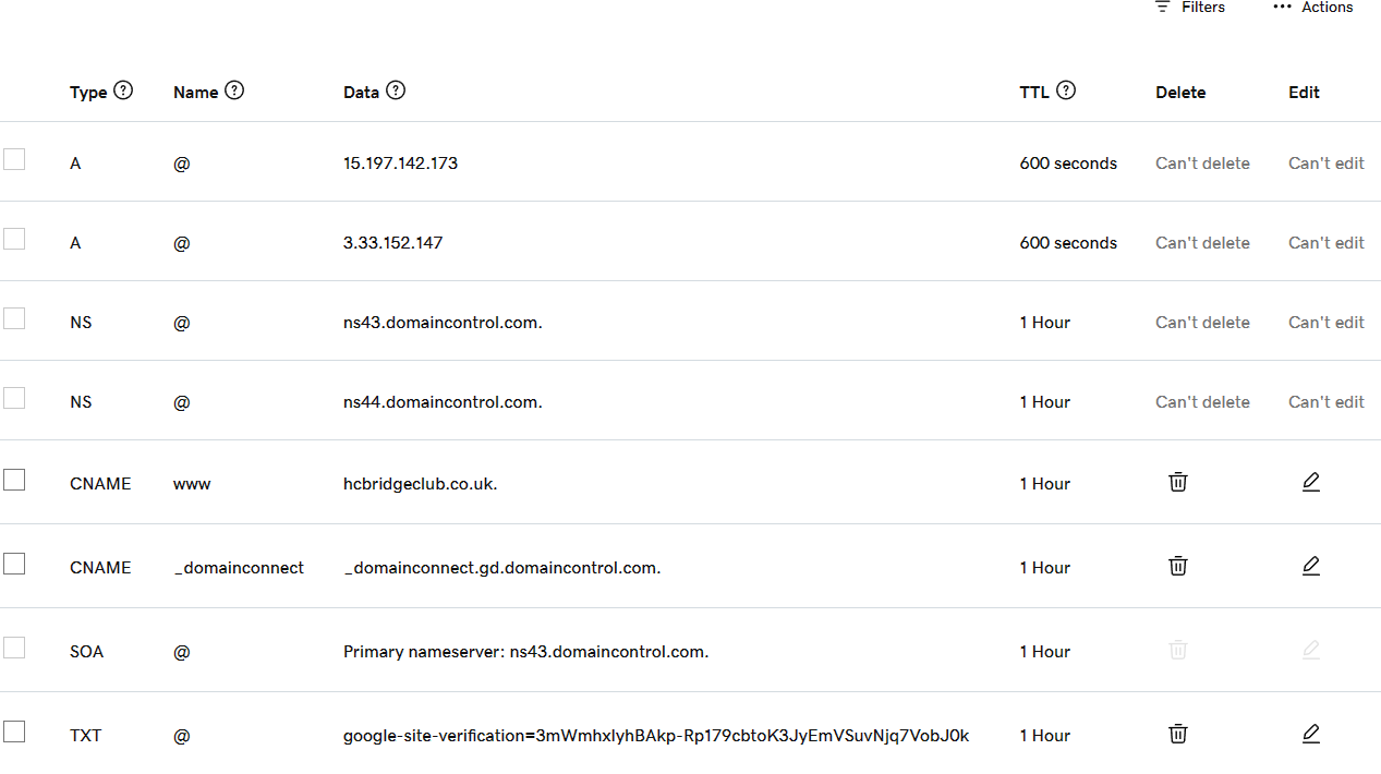

I have always used port 90 on the router, it is forwarded to port 100 on my NAS server.  It has always been like this.
Yes the url is owned by Godaddy, but the site is hosted on my NAS drive.  I have not changed any settings on the go daddy site and it has worked for years.  I have attached the settings from the go daddy site.

15.197.142.173 & 3.33.152.147 must be part of their internal workings.
31.125.40.93 is your external address for some reason it's pointing at port 90. Doing a port scan on your addess shows either neither port 80 or 90 are open or they're hidden behind a firewall, so check that port 90 is forwarded on your router to an internal device (your web server)

@jab1  Tracert is going to a Godaddy IP address which is correct. Godaddy setup forwards requests (not ping or traces) to @bryanuk 's site. I think the problem is getting through the router.

@bryanuk  DNS is working correctly and is sending requests to your router.

@jab1  DNS lookup on mxtoolbox.com shows :
Type  Domain Name           IP Address
A        hcbridgeclub.co.uk   15.197.148.33
A        hcbridgeclub.co.uk    3.33.130.190
Status Ok DNS Record Published DNS Record found
One of @bryanuk 's screenshots show these are unchangeable addresses belonging to Godaddy.
The other shows the forwarding rule to the actual site. Strange setup maybe someone more knowledgeable will explain.
