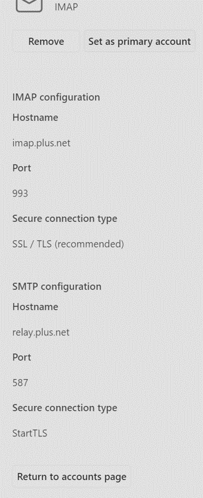

I have moved from Win 11 Mail to New Outlook. My globalnet.co.uk can send emails successfully to other email addresses that I have. However, it will no longer receive emails into the New Outlook client (they appear in webmail and on my iPhone). The settings I am using are below and taken from another post here for Plusnet email addresses.  Does anyone know the correct Inbound IMAP settings for globalnet please?
Inbound IMAP - imap.plus.net port 993 encryption TLS/SSL
Outbound SMTP - relay.plus.net port 587 encryption STARTTLS

Thanks for the suggestions. Sadly they have made no difference. I have systematically tried each combination singly and together. The account config screen in the New Outlook is far more limited than it used to be (see attachment). Outgoing mail is no issue. Incoming mail just doesn't work. There is clearly a setting for it but I've no idea what.
