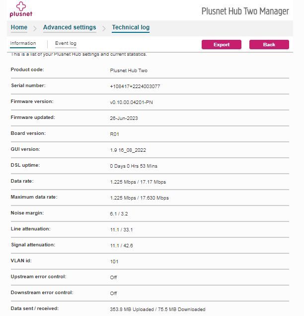

@destiny234 Could you post those two pages from your router again, please, would be interesting.

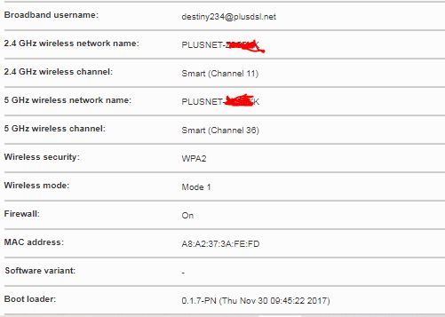

Re: Speed Ok ish but everything has slowed down

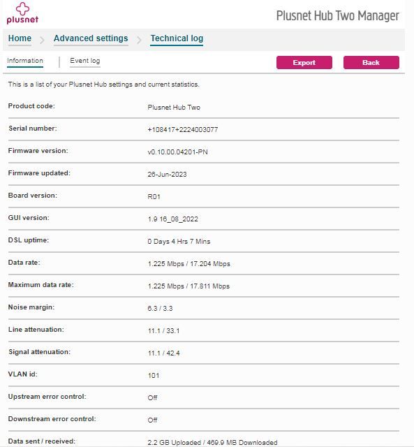

Are those new screenshots, Linda? If so, the problem is not resolved.

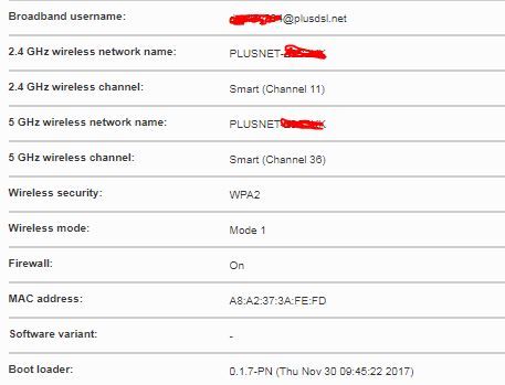

Sorry John, I think you mean the new ones, hang on .....
Still not corrected, looking at that, Linda,  Can you post a result from this speed test site, please https://www.speedtest.net/ .

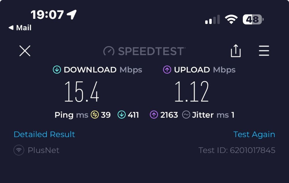

destiny234
Posts: 35
Thanks: 4
Registered: ‎15-10-2020
speed test after.jfif
Yes, the speeds are reported 'back to front', and the upload is wrong for your attenuation, but the thing that makes me wonder if things are corrected is your downstream SNR figure of 3.2 -that is much too low for a line of your length - it should read 6.0 or slightly higher.
The speed test would confirm if what they claim to have done has had any effect.

Posts: 22,759
Thanks: 7,972
Fixes: 334
Well, your download is much better, but I'm still suspicious of the SNR . Your upload speed is probably about right for your line though. - I forgot it can in theory reach 10Mb/s on FTTC.
OK. I'm away in Devon for 4 or 5 days from tomorrow, so probably won't be around until after the evening meal, but I'll keep my eyes peeled, The problem with such a low SNR is that if there are any errors, there is no 'wriggle-room' and you could see your speeds plummet again as the Dynamic Line Management (DLM) tries to correct for them.
