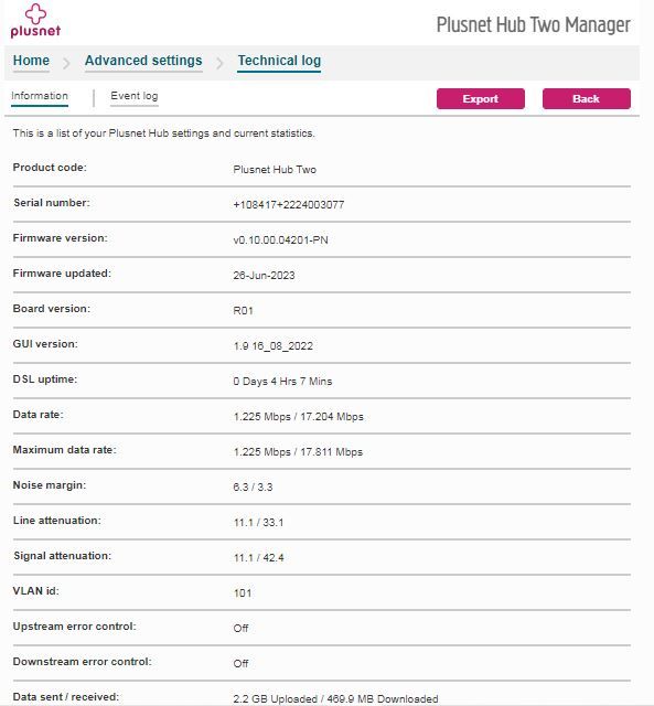

Thanks for those, Linda - they are strongly suggesting a fault. Would be interesting and informative to see the Hub data and results of phone-line test, too.

John,
The quiet line test was ok,
I can`t find this on the home screen `
For the Hub Two -
Linda

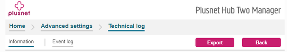

Glad the phone is OK - one less avenue of possible issues, Does the picture below help you find the required page?

Linda - it is on your router.
Re: Speed Ok ish but everything has slowed down
25-07-2024 4:19 PM
Use this link http://192.168.1.254
From Home page bottom right >Advanced settings; Middle left >Technical log; you'll need the admin password from the card
25-07-2024 4:40 PM - edited 25-07-2024 4:40 PM
Thanks for that Linda. It is good to find someone who asks for help and then helps us to help them. From that last bit of info, I'm 99% confident there is a fault on the OpenReach network, so suggest you initially report it via https://www.plus.net/help/report-a-problem/
If it comes back and says there isn't a fault, let us know and further advice can be given, but I'm confident it will suggest getting OR out.
