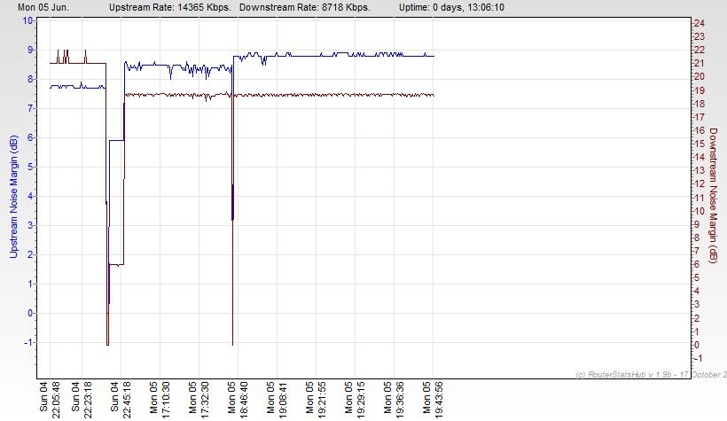

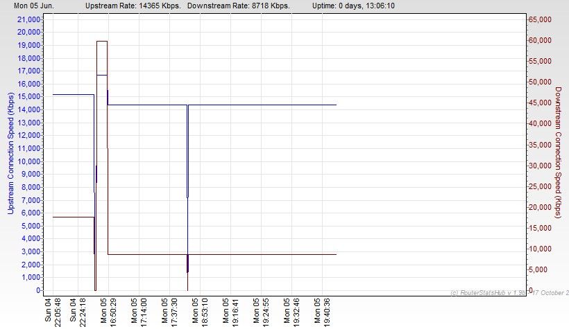

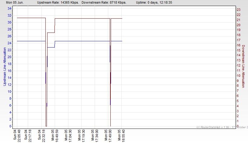

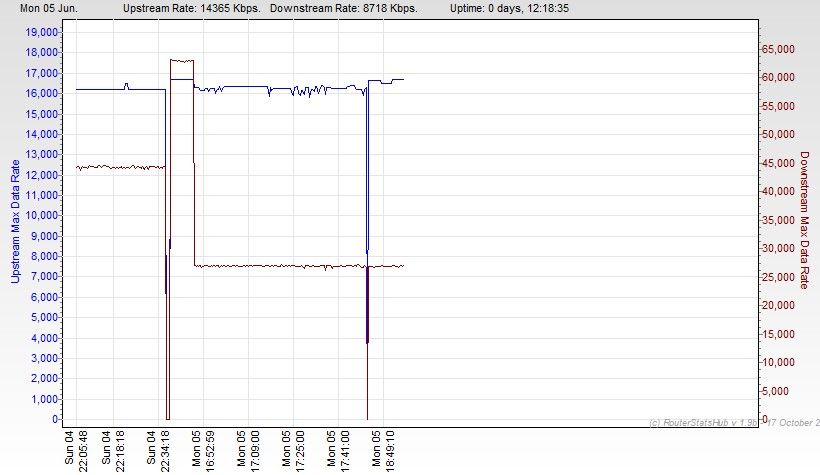

So, after speaking to an Advisor earlier today that ran some line tests and couldn't detect a fault he has arranged for an OR engineer to come out tomorrow.  We shall see.
I reckon it's the box of wires on top of the pole where the issue lies. It was last time. The engineer found some corrosion of the wires/connectors and he cleaned these up and it was fine for months. Perhaps damp gets in? It serves quite a few houses but none of the neighbours I spoke to noticed issues but they probably wouldn't notice anyway.
Now a measly 5.8 down and 11.6 up
Ignore the drop-out below. The PC went to sleep on me after a while when i was out.

Now that I am looking at these on the desktop, I can see that you have not used the settings I requested.  There is nothing like enough granularity here to be of any help.  Also this does not appear to be running 24x7.
Sample interval needs to be 10 seconds and 720 plots per graph. That will result in one graph every two hours.  Only the SNRM graph is of interest, until there is something of interest to look at in detail.  That said, the variable attenuation is a tad unusual.
Can you please change the settings and restart the router.  Given that you appear to have intermittent noise, there is a fair change it will sync at a higher speed ... until the next incident.
Have you identified the source of the massive download?

  • Also this does not appear to be running 24x7. - Yes, I need to set my PC to Not Sleep
  • Sample interval needs to be 10 seconds and 720 plots per graph - Yes, now configured this.

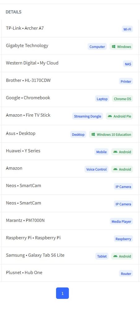

No idea about the massive download. Given the speed I was getting and the short amount of time that accrued (4 hours?) it seems an anomaly?  Current DSL Uptime is 12:53hrs and 7.3GB received. Is this more normal?
Fing Screenshot of currently/typically connected devices. The TP-Link is a router used as an Access Point to cover downstairs/garden area.  That is then connected to a 5-port Gigabit Ethernet Switch to feed a Printer, Smart TV, Streamer Amplifier.  I was keen to have hard-wired connections due to previous speed issues causing buffering that I thought might be caused by wifi issues but now probably the same issues I'm having now.

What is "normal" all depends on what you are doing.
Not sure when my router (Hub Two) resets its counters (might find out tonight) but I have only downloaded 36GB in either 5 days (xDSL / PPP uptime) or 220 days (system uptime).
I have a smart TV (Netflix and Watch on Demand / catch-up), Amazon Fire and multiple laptops all connected to the same iCloud services.
I would find 7.3GB in 12 hours VERY excessive.
I could envisage the smart cameras generating a good deal of UPLOAD but not downloads.

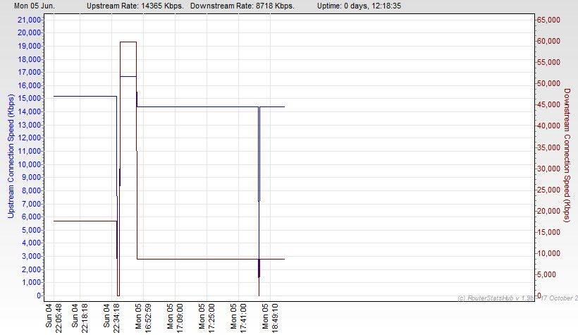

Typical! Absolutely rock steady since the last restart at 19:45 last night.
Don't know what the engineer will find on his visit now.
