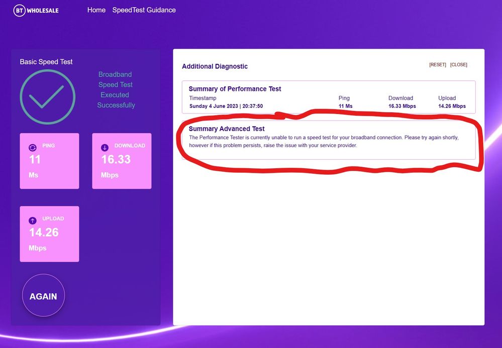

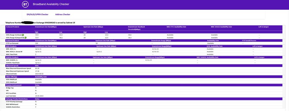

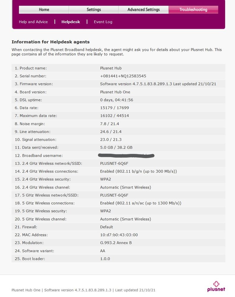

NicDB
Posts: 63
Thanks: 9
Registered: ‎20-11-2020
Re: Speed Keeps Dropping - Massively
Thanks Jab1.
Screenshots attached as requested.  The BTW Performance tester won't complete the additional diagnostics despite trying 3 different browsers.
As I've said previously we have had an OR engineer onsite last year who checked all the wiring, replaced a master socket, rewired an extension and gave the whole thing a clean bill of health.  There are no issues internally. The Plusnet bot keeps saying the line is fine and sends me a list of things to do which we have done umpteen times. It's just really frustrating and pretty poor serive.
Screenshot 2023-06-04 203707.jpgScreenshot 2023-06-04 203842.jpgScreenshot 2023-06-04 204148.jpg

Posts: 25,288
Thanks: 9,141
Fixes: 387
@NicDB The Help Desk shot is extremely informative - you have a ridiculous D/s noise margin, and I suspect, a major error in the BT/OR network - your uptime suggests you are suffering from repeated xDSL disconnections.
To confirm my suspicions, can you post the output from the WAN tab of your Hubs Event Log, please? Once you have done that, I will confirm for you that you have an issue which requires serious investigation by OpenReach.
