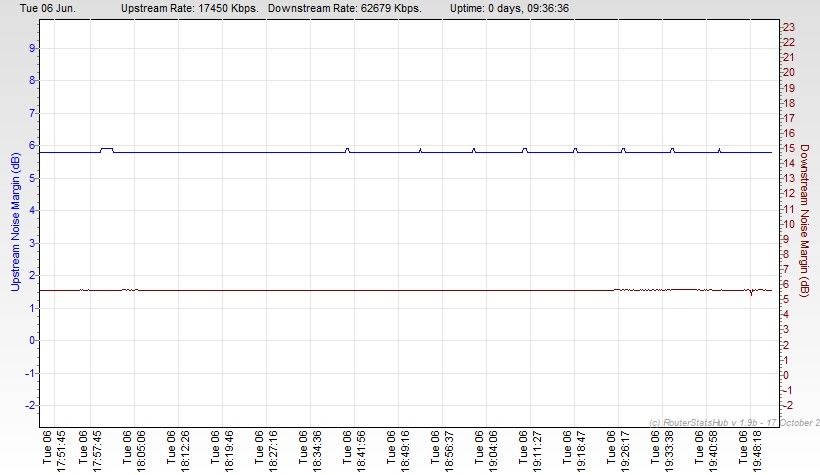

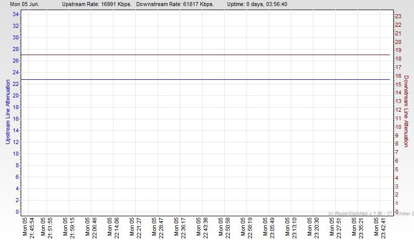

Re: Speed Keeps Dropping - Massively

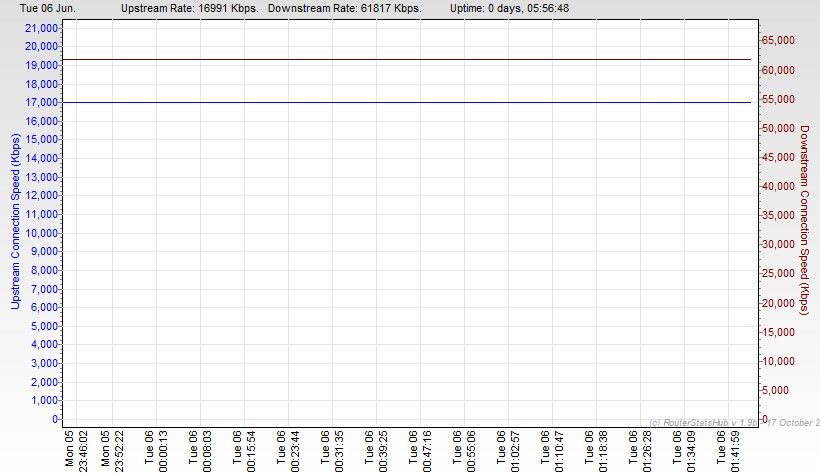

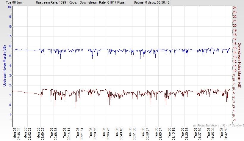

RSHub-Line Attenuation-20230606-014610.jpgRSHub-Max Data Rate-20230606-014610.jpgRSHub-ConnectionSpeed-20230606-014610.jpgRSHub-NoiseMargin-20230606-014610.jpgRSHub-Line Attenuation-20230605-234602.jpgRSHub-Max Data Rate-20230605-234602.jpgRSHub-ConnectionSpeed-20230605-234602.jpgRSHub-NoiseMargin-20230605-234602.jpg

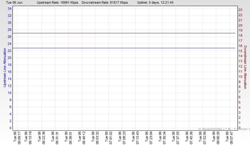

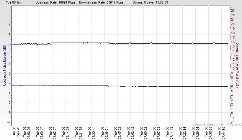

RSHub-Line Attenuation-20230606-054626.jpgRSHub-Max Data Rate-20230606-054626.jpgRSHub-ConnectionSpeed-20230606-054626.jpgRSHub-NoiseMargin-20230606-054626.jpgRSHub-Line Attenuation-20230606-034618.jpgRSHub-Max Data Rate-20230606-034618.jpgRSHub-ConnectionSpeed-20230606-034618.jpgRSHub-NoiseMargin-20230606-034618.jpg

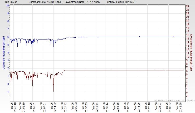

@NicDB
This is VERY helpful and tells us a great deal ... but probably not great news for you!

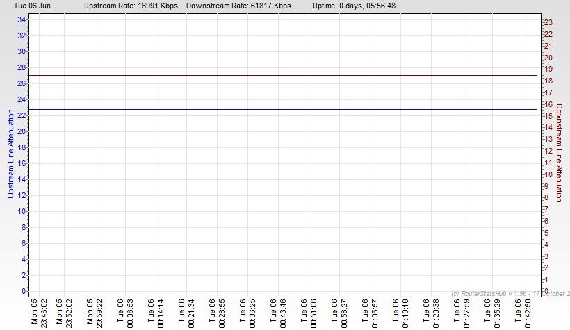

You only need to post the SNRM (Noise Margin) plots please.  Here is a summary of what the ones you have posted show...
  • Sun 22:05 to Mon 19:43
    appears to be "rock steady" but there is insufficient granularity to be of any help
  • Mon 20:43 to 22:40
    distinct noise starts at 22:17
  • Mon 21:45 to 23:42 (odd overlap!)
    noise at 23:27 onwards is clearly cyclic suggesting something running a service cycle of some description
  • Mon 23:46 to Tue 01:42
    really grim noise from 00:00 onwards
  • Tue 01:46 to 03:42
    noise ceases abruptly and completely at 02:21
  • Tue 05:46 to 07:44
    no noise at all
Would I be correct in inferring that the missing graphs between 03:42 and 05:46 are all "flat lines"?
If that is correct, then I would conclude that you do have REIN arising from the operation of some electrical equipment between 22:17 and 02:21 - close enough to a 4 hour duty cycle.  That equipment could equally be within your home or outside of your home (think street lighting).
I doubt that the BT engineer will find anything specific as sorting these issues often requires a REIN trained engineer and you will not get one of those until TWO ordinary engineers have not found a fault.  That said a bad joint can cause an AC line balance issue which will make a circuit more susceptible to REIN - see AC Balance issue... (kitz.co.uk)
Reducing susceptibility is not an easy task, it first needs an engineer to consider the matter and then (if there is an imbalance) be able to find and rectify the cause.  A far more productive approach would be to identify and eradicate the source of REIN.  See ::. Kitz - REIN, SHINE & RFI .::
Your first approach to this should be to keep running router stats 24x7 this is your most valuable insight to YOUR issue.  Note the use of the telephone handset when noise is observed will be helpful.  Notice when the noise starts and then try to correlate that with activity within the household.  If you can identify something which has "switched" on, then switch it off and see if the noise disappears, either suddenly or gradually.  A portable AM radio tuned to 612kHz will be useful.
The source of the noise could be something which you perceive as always on, but which at times comes under a stress load.  This might be relevant here - my "baptism by fire" with this stuff was eventually traced to the CCTV camera power pack. Current switch mode power supplies are notorious for going pear shaped and throwing out lots of RFI.  What was happening is that as dusk fell, the IR illuminators kicked in thereby drawing far more current putting the PSU under extreme load, giving rise to RFI.  Switch it off and the SNRM flat lined.  Turn it on after it had cooled down and then over 10 or so minutes, then SNRM plummeted.
I note that you have smart cameras in your network, so this is worth a look.
Do you have PIR switched outside lights?
Do you have a HAM radio operator in the area - the lime window is typical of those seeking long distance communication.  I cannot recall - does that version of router stats plot the tone bins?  See https://kitz.co.uk/adsl/rein.htm#HAM
In case you are wondering what is the relevance of this is, it might help to revisit the earlier explanation of how re-sync works.  If there is a noise event sufficient to drop the sync (SNRM hits zero), the line will re-sync at a lower speed to maintain link stability.  The link will only re-sync again if the link drops.  Based on the evidence you have provided, if you find that the link is slow in a morning, I would expect that a router restart will deliver the normal speed stably throughout the day ... until the RFI returns from wherever.  However as you have noted repeated restarts of the router are not ideal ... the DLM will then start to be really aggressive and might chronically band the line.
This might be a long journey, but it might find a suspect power supply which is working outside of its design envelope and in the extreme could possibly be a fire risk.  The search would be worth it for full peace of mind.  See here - https://modwiggler.com/forum/viewtopic.php?p=1047994&sid=8d2cb4d0db5791c06297bc26b03e048c#p1047994 - notably two posts further on.
One extreme approach for avoiding the impact of REIN if it cannot be found and eliminated (particularly if it is outside of your property) would be to upgrade to FTTP if that is available.  RFI does not impact the operation of FTTP services.

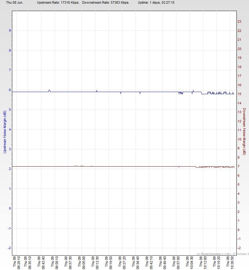

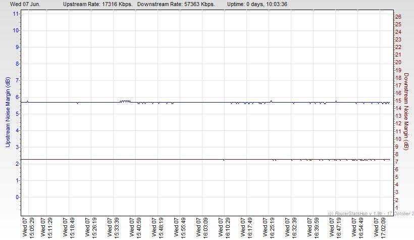

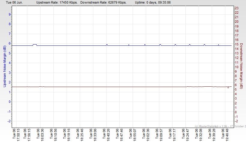

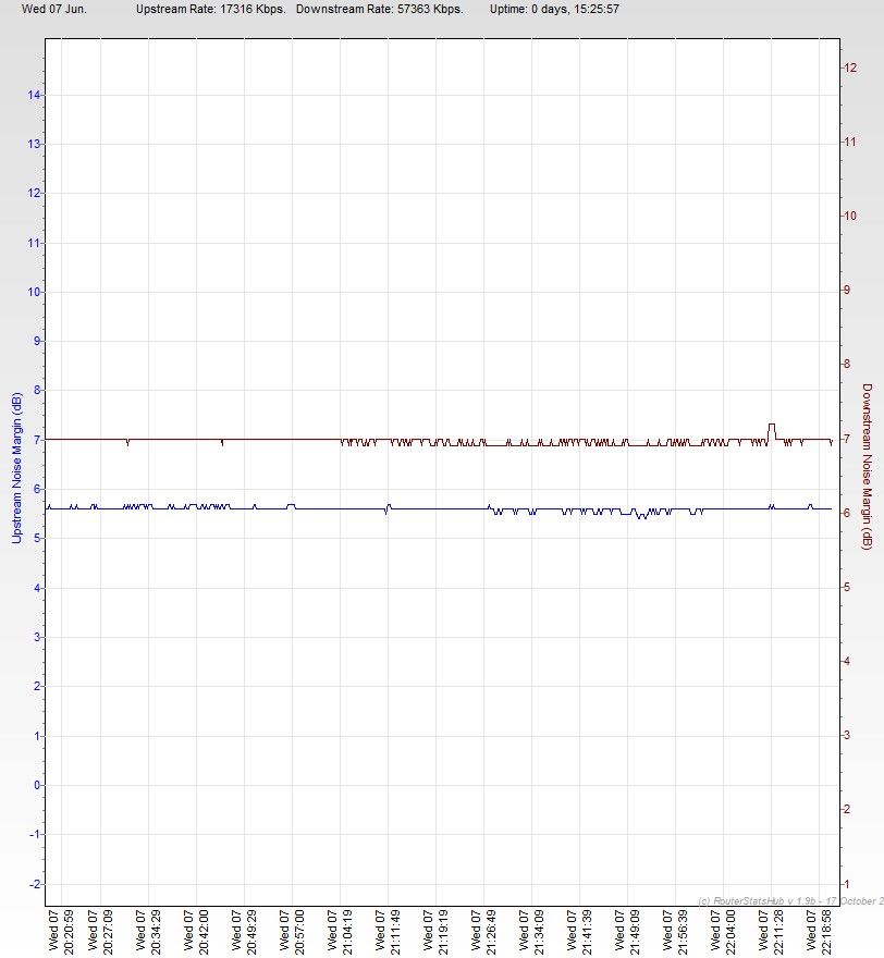

Here are the SNRM plots.
RSHub-NoiseMargin-20230606-014610.jpgRSHub-NoiseMargin-20230606-034618.jpgRSHub-NoiseMargin-20230606-054626.jpgRSHub-NoiseMargin-20230606-074816.jpgRSHub-NoiseMargin-20230606-081114.jpgRSHub-NoiseMargin-20230606-094822.jpgRSHub-NoiseMargin-20230606-114840.jpgRSHub-NoiseMargin-20230606-134848.jpg
RSHub-NoiseMargin-20230606-154856.jpgRSHub-NoiseMargin-20230606-175015.jpgRSHub-NoiseMargin-20230606-185727.jpgRSHub-NoiseMargin-20230606-195028.jpgRSHub-NoiseMargin-20230606-195205.jpgRSHub-NoiseMargin-20230606-195209.jpgRSHub-NoiseMargin-20230606-230208.jpgRSHub-NoiseMargin-20230607-010212.jpgRSHub-NoiseMargin-20230607-030213.jpg

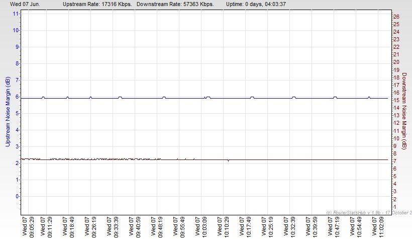

RSHub-NoiseMargin-20230607-050213.jpgRSHub-NoiseMargin-20230607-065856.jpgRSHub-NoiseMargin-20230607-070529.jpgRSHub-NoiseMargin-20230607-090529.jpgRSHub-NoiseMargin-20230607-110529.jpgRSHub-NoiseMargin-20230607-130529.jpgRSHub-NoiseMargin-20230607-150529.jpgRSHub-NoiseMargin-20230607-170529.jpg
Posts: 23,756
Thanks: 8,442
Fixes: 357

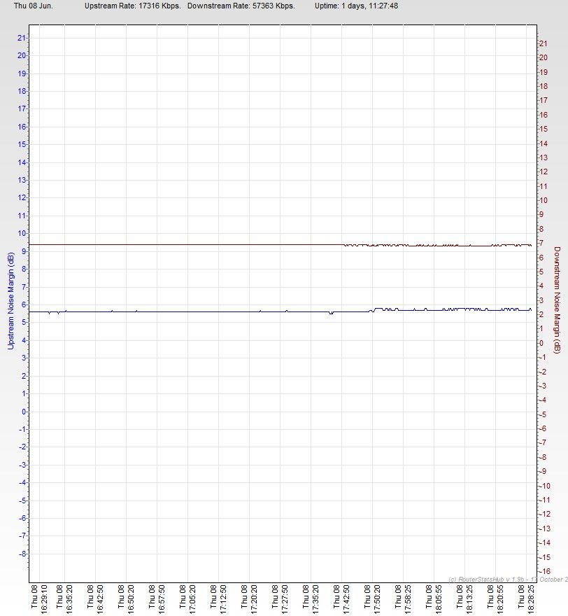

@NicDB I'll leave it to @Townman to fully comment, but what did you turn off? To my untrained eye, those SNR plots look reasonable - apart from the initial one - before you turned 'something' off?

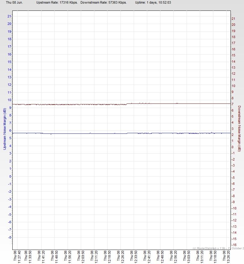

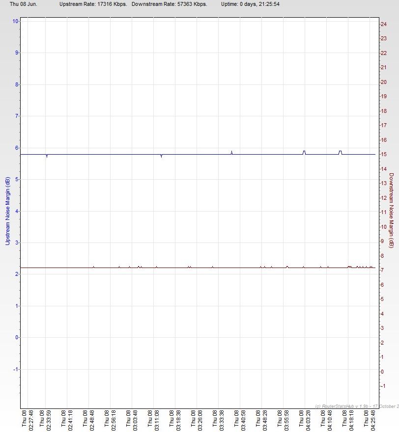

RSHub-NoiseMargin-20230607-222714.jpgRSHub-NoiseMargin-20230607-222751.jpgRSHub-NoiseMargin-20230608-002748.jpgRSHub-NoiseMargin-20230608-022748.jpgRSHub-NoiseMargin-20230608-042748.jpgRSHub-NoiseMargin-20230608-062748.jpgRSHub-NoiseMargin-20230608-082910.jpgRSHub-NoiseMargin-20230608-102910.jpg
The scale kinda changes somehow?

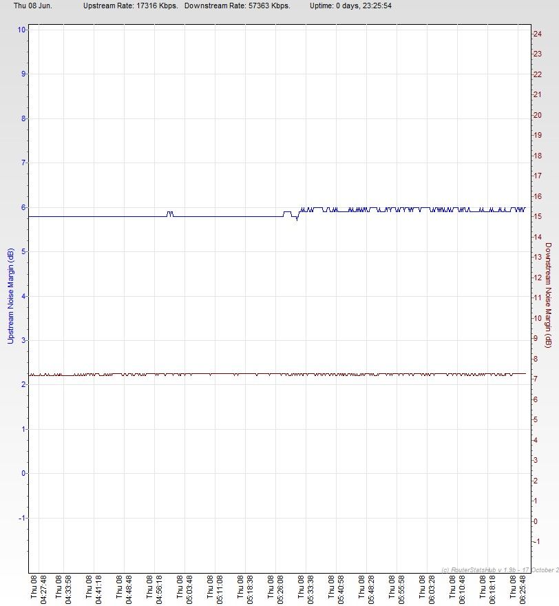

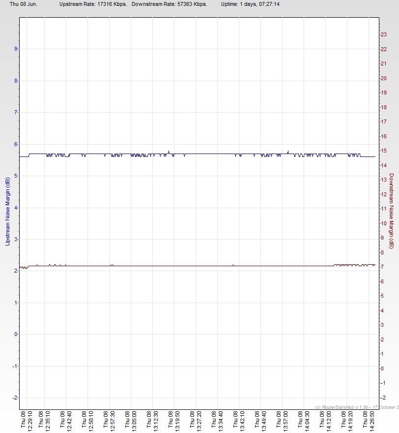

RSHub-NoiseMargin-20230608-122910.jpgRSHub-NoiseMargin-20230608-142910.jpgRSHub-NoiseMargin-20230608-162910.jpgRSHub-NoiseMargin-20230608-175437.jpgRSHub-NoiseMargin-20230608-182945.jpgRSHub-NoiseMargin-20230608-202945.jpgRSHub-NoiseMargin-20230608-222945.jpgRSHub-NoiseMargin-20230609-002942.jpg
Posts: 23,756
Thanks: 8,442
Fixes: 357
There's still something going off - it appears to have lost some stability after the 01.23 drop on the 7th - but as I said, I'll leave further comment to the expert.
Posts: 28,682
Thanks: 12,894
Fixes: 240
@NicDB

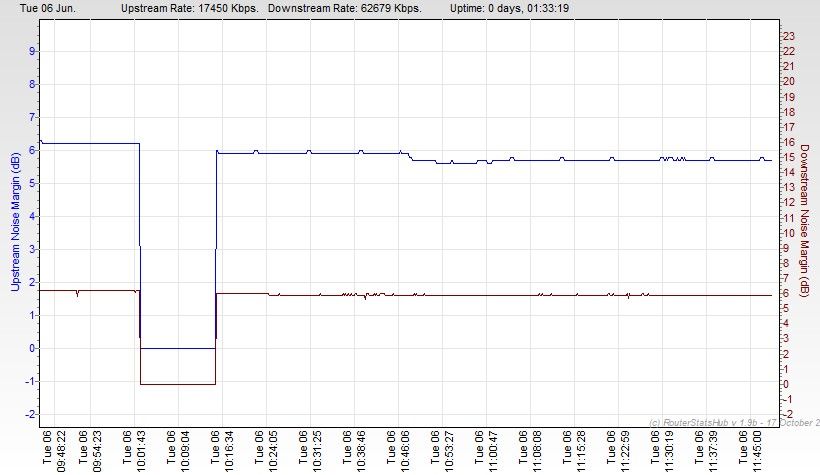

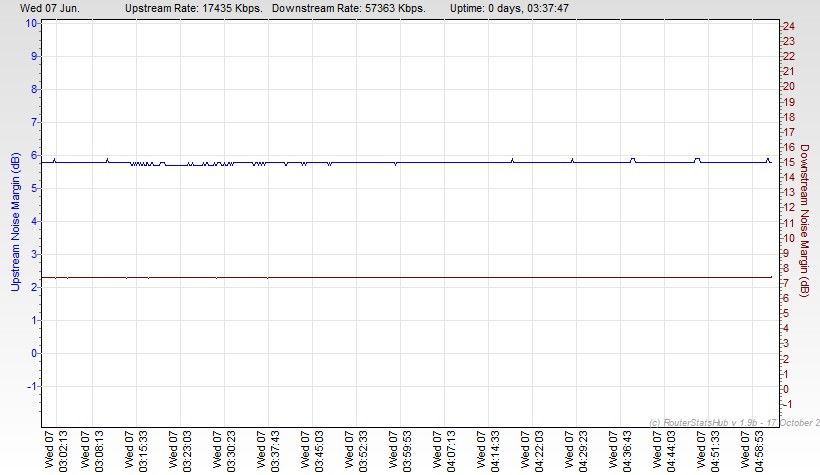

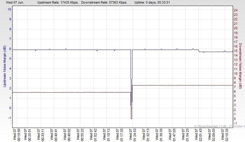

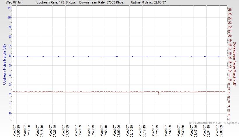

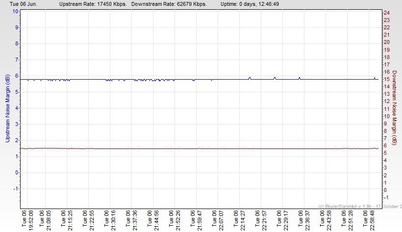

Great monitoring!!  Something is being elusive here!
As discussed before Tuesday 6th 00:00-02:21 was a tad grim and was "Of the shape" of not good news.  That said it has been fairly clean since then.  Have you run the dish washer again through the period you have been monitoring?
In many REIN situations there are more than one source of noise and there is some evidence of this here.
Tuesday 03:15 onwards there is something switching OFF for a few seconds at a 25 minute interval.  From 03:52 the frequency doubles (12 minutes) - any idea what that might be?
Tuesday 10am - long drop - was the the BTOR visit?
Wednesday 01:25 drop and a loss of speed 62.6mbps down to 57.3mbps - no obvious build up - the link just vanished.  Any thoughts what might have happened at that time?
Wednesday 07:02 drop no speed change - ditto?
Wednesday 23:26 looks like something switched off - ditto?
Thursday 05:30- ditto - ditto?
Is there anything you are aware of that you have not done which you do normally?
The graphing suggests that what blighted your line on Monday evening and reduced the performance to 17mbps has not reoccurred.  Given that the engineer has again found no issue with your line, I suggest that there are fair grounds to conclude that this is REIN (electrical interference) from a source as yet not identified.
I would recommend continuing to run the monitoring.  The fact that whilst there is nothing going wrong, there is no point running the monitoring would not be a good approach.  Keeping the monitoring active will ensure that should something happen, your will have captured the profile of the event.
You might be able to improve the graphs by modifying the axis settings - I think you can do that on the BTHH5a version (you sure can on others).  Set the axis to minimum zero and max 12.
Keep monitoring, if not using the computer leave the graph display on ... should you see the graph "move" have a think / look around to see if there is anything thing you can correlate to the event.
Telephone handset to listen to the line from time to time will be really useful, as will an AM radio tuned to 612kHz.
Data usage - yes I would have said that is excessive - however, I have just checked mine following a restart 3 days ago.  I have used 19.6GB in 3 days 21 hours ... and I do not have a clue what has used it!
In that time, I have not streamed Netflix, catch up TV - purely email on multiple devices (two laptops, two tablets and mobile phone).  Dropbox and OneDrive across the lot.  mobile and one tablet also connected to iCloud.
Then there is the Sam Knows internet performance survey box - who knows what that is up to?  Similarly there are other unknown quantities - 4x smart switches, Smart TV, Cloud connected NAS and Alexia (on Amazon Fire) downloading unrequested advertising, with the requested music interspersed.
So may be your usage is not as horrid as it appeared to be.  Would now like to understand what is burning my broadband.
