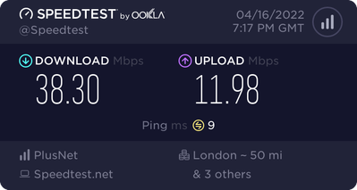

Ok so yesterday I contact support as my internet speeds has seem to have dropped a lot in the this week
He said they was getting an engineer out this week on Thursday but The are no tickets for my contract to the support team?

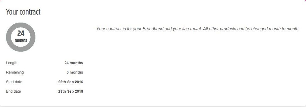

Also he said that I had renewed my contract with plusnet I did a new contract in May 20 2021 for 18 months should end soon But yet my prices has already increased as you can see from the bill above my contract should end 20th January 2023
See support Id 214493625 for said contract start.
above image says I don't have a contract
Can someone look into all above
