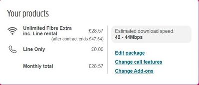

Ok so yesterday I contact support as my internet speeds has seem to have dropped a lot in the this week
He said they was getting an engineer out this week on Thursday but The are no tickets for my contract to the support team?
I got a text from a company I've never heard of QubeGB confirm my appointment.
Also he said that I had renewed my contract with plusnet I did a new contract in May 20 2021 for 18 months should end soon But yet my prices has already increased as you can see from the bill above my contract should end 20th January 2023
See support Id 214493625 for said contract start.
above image says I don't have a contract
Can someone look into all above

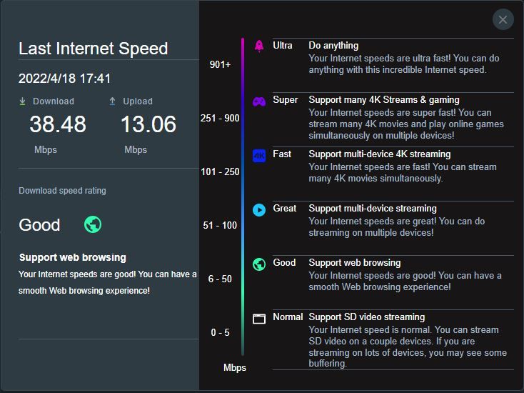

However it does have its own speed test built-in
Then when you click on the good it tells you your speed and what it means see below.
Strange as fibre is sold as you can stream from multiple devices at the same time yet it says here it only good for standard browsing,
Dean

Re: Slower speeds
Hi Dean,
It all depends on whose "bible" you read - see What internet speed do you need? Find internet plans on CNET - CNET
How much internet do you use?
These days, with so many people working from home, a lot of us are using more internet than we're used to. However, that isn't the case for everyone, which you'll want to keep in mind as you're shopping for an internet plan.
If you work from home, stream lots of high-resolution videos or regularly play games online, you'll likely need more internet speed than someone who casually goes on social media platforms and gets their TV from a cable provider.
Different activities require different internet capabilities -- here's a small chart to help give you an idea:
INTERNET SPEED RECOMMENDATIONS
Activity Usage required Our recommended speed
Email 1Mbps 1Mbps
Web browsing 3-5Mbps 5-10Mbps
Social media 3-5Mbps 10Mbps
Video calls 3-5Mbps 10-20Mbps
HD streaming 5-10Mbps 10-20Mbps
Online gaming 3–6Mbps 25-35Mbps
4K streaming 25Mbps 35Mbps
I suggest that the guidance provided by your router is more than a tad conservative!
Whatever, again that is data rates, not the line stats which tell much more about what is happening.  Try looking at DSLstats as an alternative monitor - see DSLstats Home page - I have NOT looked to see if it works with your router.
