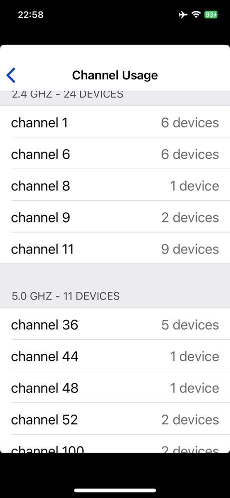

Re: Issues with buffering/lag
Thank you, that link is super helpful!
So any unoccupied 5ghz channel is okay to use. Hopefully nobody else will pop up on 44. I’ll monitor 1, 6 and 11 on 2.4ghz and see which consistently has the least devices on it. If I get the chance I’ll ask my neighbours to shift their stuff off 2 and 9.
Being able to identify the source of the anti social use of 2 and 9 and fixing it would be beneficial to everyone involved.
It has improved. I am on 5ghz now. I tried running speed tests one after the other on both bands, and the 2.4ghz one is returning 32mb downstream vs 37mb for the 5ghz. I have been able to watch an hour of streaming video without buffering for the first time in a week.
It seems coincidental at the moment!
I’m going to have to talk to the neighbours though — someone’s on channel 8 as well.
Use channel 1 so 8 & 9’s use is of no consequence to you..
Someone has something on channel 2, so it does need to be sorted. The “antisocial” stuff is all intermittent, so I think it’s things like laptops (as one has Asus in its name), maybe mobile phone hotspots too. I’ve done a scan just now and everything is on 1, 6 and 11, but I am sure the other things will pop up later, either when the neighbour’s kids come home from school or people come home from work.
I’m holding off on calling them for now, pending how the 5ghz band behaves. If I can keep a decent speed on that consistently then the problems I’ve had on the 2.4ghz are obviously all just congestion and neighbours who need to learn a little more about WiFi channels. I will move as much as I can here to the 5ghz band and/or wired connections.
