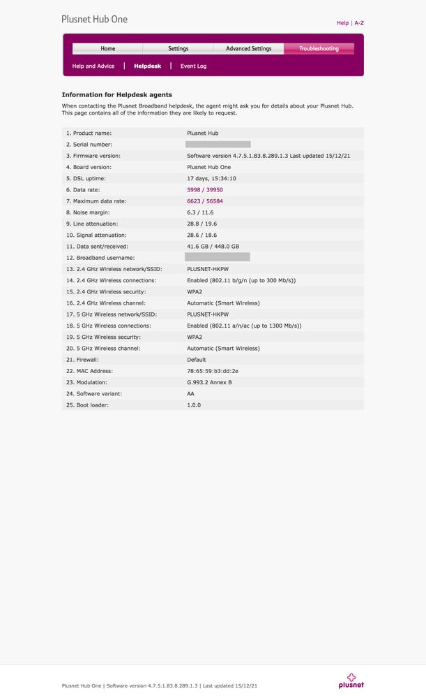

Can you post a screenshot of the Hubs Helpdesk (obscuring personal data)

The help desk is this:
Do the two different frequencies show as available in the kit?

I can’t see how to add a screenshot.
Information for Helpdesk agents
When contacting the Plusnet Broadband helpdesk, the agent might ask you for details about your Plusnet Hub. This page contains all of the information they are likely to request.

I did post a copied and pasted version of it, as I couldn’t work out how to upload a screenshot. It appears to have vanished though. Could a moderator have deleted it? I removed the serial number and username.

To upload the screenshot, click the 'mountain icon at the top of the reply window (between the smiley and camera), and follow the prompts. Your original could have been caught by the slightly temperamental spam filter.

I don’t have any of those icons. It’s just a plain text input field I see (on my phone).
Definitely has been moderation in here, refresh the thread and start from the beginning, remembering what you posted before!

Ah - the dreaded mobile version. Do you have a desktop/laptop? If not, select the 'desktop' option from the settings options.

Plusnet Hub One | Software version 4.7.5.1.83.8.289.1.3 | Last updated 15/12/21

Thanks for that - it looks OK  to me. Unfortunately I have to go out for the next couple of hours and won't be back on here tonight. I'll have another look tomorrow morning, but in the meantime I'll tag a couple of Community members who may be able to assist - if they are around.
