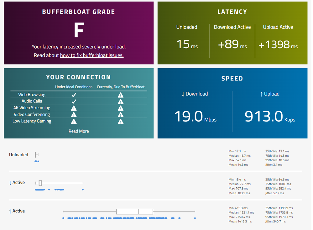

I think there are two problems here,  there are disconnections, and there are slowdowns.
The slowdowns will not be occurring during a period of Openreach disconnection - there would be nothing passing.
The slowdowns are likely to be coincident with the massive PING times as shown in Reply #27
Massive PING times are a symptom of the upload path being saturated with too much traffic.
Having done a quick Google on the VMG8924 router, there are many complaints that the router completely stops passing new traffic connections until either the existing excessive outgoing traffic data stream has completed or the router reboots the DSL connection.
Fortunately I've found an archived user guide for the VMG8924, and the good news is that it appears to support QoS that shows that it might be possible to traffic shape the upstream path, and therefore reduce the chances of the slowdowns.
The bad news is that the Plusnet Hub 2 will also suffer high PING with a lot of outgoing traffic, but does NOT have QoS.

If you now navigate to the QoS control page shown below
Lets try getting those LATENCY figures better using some guestimate starting numbers -
Try setting -
        "WAN Managed Upstream Bandwidth" = 750 Kbps
        "LAN Managed Downstream Bandwidth" = 16000 Kbps
        "Upstream Traffic Priority Assigned by" = "Packet Length"
then set
        "QoS" = "Enable"
and press the "Apply" button, and wait for whatever it does next.
Then re-run the  https://www.waveform.com/tools/bufferbloat  test, and post a screenshot of the result.
If this works, it might take a few iterations to get the setting closer to ideal.
That seems to have given me an 'A'!
I've just tried a YouTube video & a quick iPlayer stream and I can get HD possibly 4K, so all good.

Re: Intermittent slowdowns
@hugonebula
WOW that's an improvement !
Those settings are about as good as you are likely to get with your current sync speeds.
If you are happy with the connection as it is now, do you want to give it a few days of real world use and see how it goes ?
Your limiting factor here is your upload speed,  as most QoS algorithms struggle down at around 700Kbps, so "Upload Active" latency at +24ms is a big win !
If you did want to iterate your settings at all, you might want to increase slowly the QoS downstream bandwidth and re-test, to see if you can increase your download speed test result, but doing so will increase the "Download Active" latency,  and I'd suggest not letting that get beyond +20ms (but in my opinion the +14ms you got is near enough what I'd be happy with).
