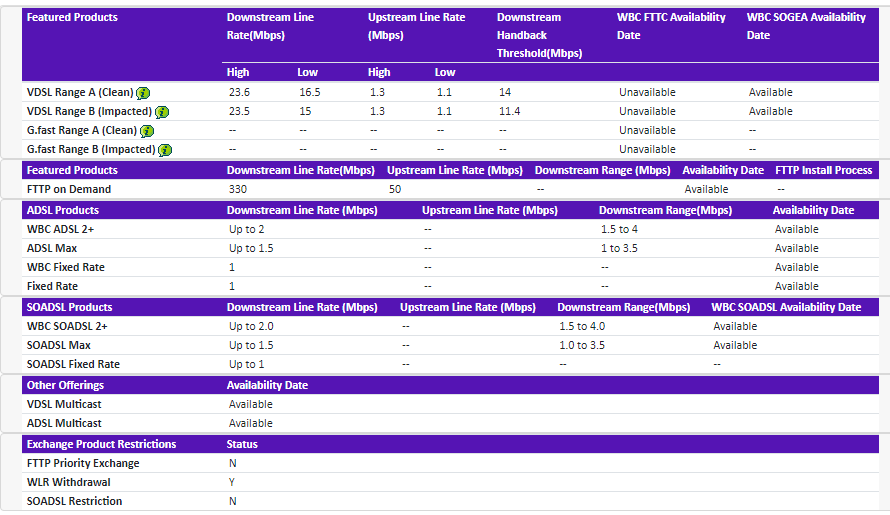

All carried out when my line is fine:
BT Speedtest + Additional diagnostics using my landline number (I don't know the other numbers)BT Speedtest + Additional diagnostics using my landline number (I don't know the other numbers)BT AvailabilityBT AvailabilityTechnical log 1/2Technical log 1/2Technical log 2/2Technical log 2/2

You are obviously a long way from the cab, but that is incidental, and won't be causing your issue.
However, a couple of things stand out to me from the Technical log - your download SNR is much too low for your Line/signal attenuation, it needs to be at least 6dB, and you also appear to be losing xDSL sync.
You need to contact PN (on Monday, I don't recommend weekends) and ask them to carry out manual tests, the bot can't handle situations like this.
Just to confirm my thoughts, can you export the error log, and post the resulting file - as an attachment - please?
