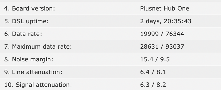

Hi Adam
It's the Plusnet router that's syncing at 76.3 as per my screenshot, it isn't syncing at 79.9 despite what the Plusnet portal is saying.

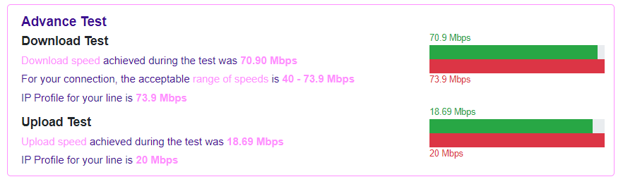

Not doubting you, but what does BTW Performance Tester say if you run the 'Additional Diagnostics'?
Icipher
Posts: 10
Thanks: 5
Registered: ‎19-05-2022
Re: DLM Reset / Line Cap
Hi John
Good idea, see below - that's confirmed my line does have a lower profile applied and I will not be able to get back to 79.9 like it was without some intervention?
Posts: 25,387
Thanks: 9,199
Fixes: 388
Yep, for some reason, PN's is set at 73.9 -  only they will be able to tell you why.

The line did drop around the time you said you did the reset @Gandalf but nothing has changed speed wise as of yet, it just synced straight back as it was.. my understanding which of course may be wrong is that DLM sets the line back to it's max then daily during the night drops it down to what is stable based on the days stats so still not quite sure why the modem in the Hub is only able to sync at 76.34Mbps and your systems seeing 79.99Mbps 🤕
