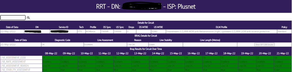

I'll attach below a full copy of the testing which I can see. To start with, a GEA Service Test:

Looking at what we call RRT data is showing the raw sync rate at 79998.
I wonder if the Hub calculating the data rate in the same way which a GEA does? Seeing as it's exactly the same figure.
