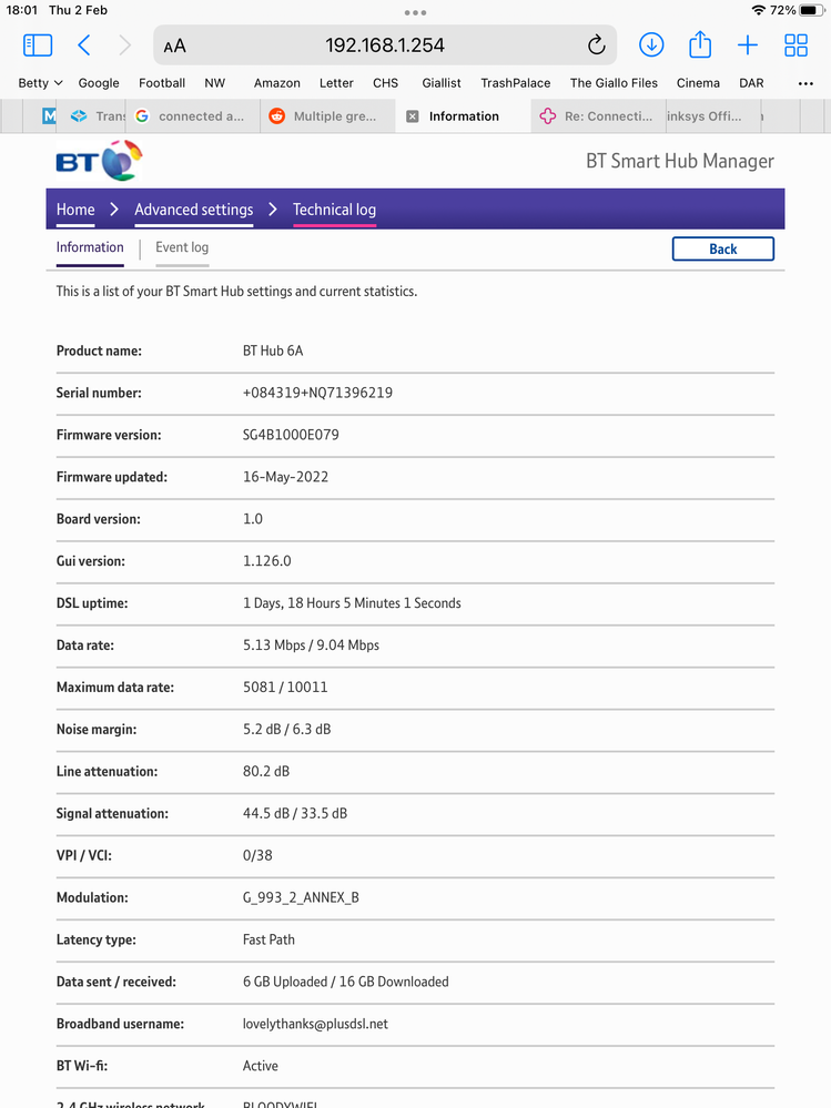

@Lovelythanks look at categories in event log and if the is an option for WAN select that. Saving the event log (captures all the Hubs activities) and attaching it to the thread would be more useful rather than screen shots. However attaching files is no straight forward using a smart phone/tablet, you need to select desktop mode on the browser.

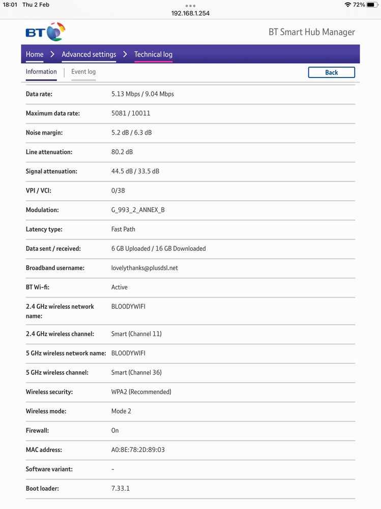

Posting a screen shot  Technical Log >Information tab would also be very useful.

information details57E8360A-F01D-4F9E-8D9C-33F2E5BA24D1.pngE22F5CF7-51DF-4313-9732-6E78BAF0BCED.png

@Lovelythanks Thanks for those event logs &c. I have just had a quick scan through the event logs, and you have had a number of DSL drops over the period, which I suspect are due to issues with the BT/OR infrastructure.

@Dan_the_Van EIGHTEEN VDSL link down messages in that shortish log - any comments?

a potential high resistance fault was reported before by plusnet support, this would not help the situation.
