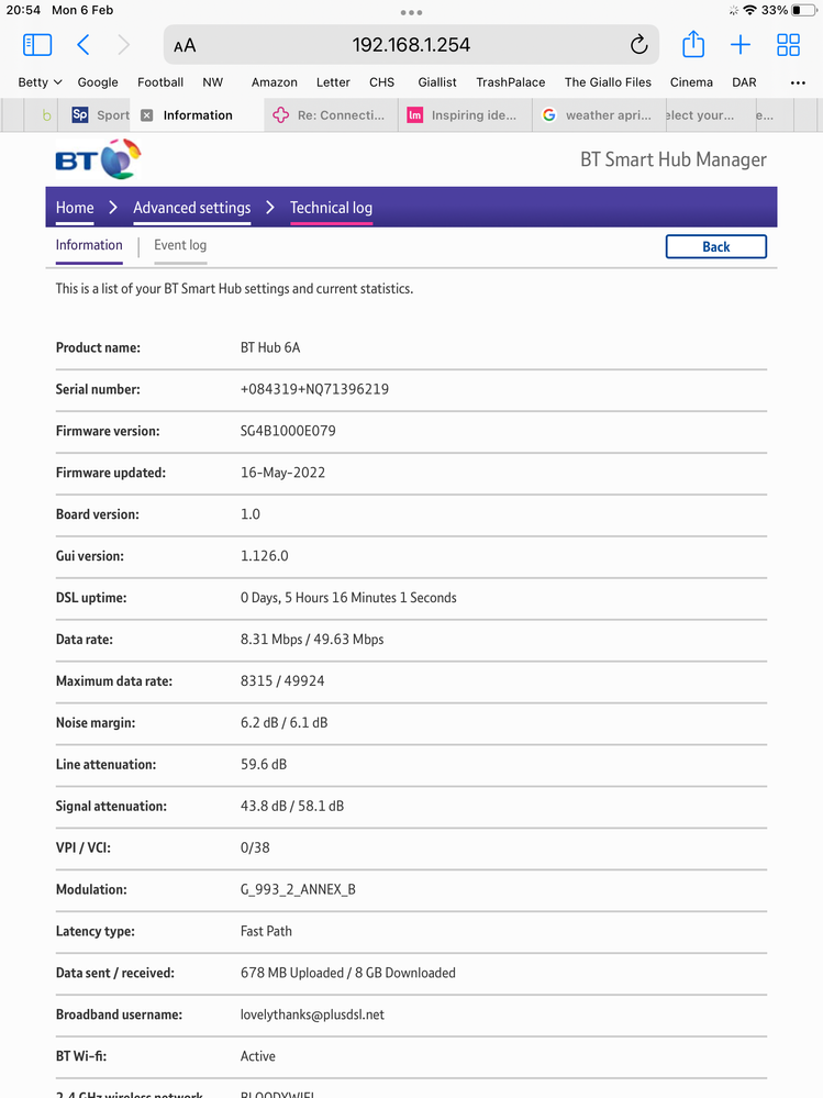

EDIT: Can you post the current 'Technical Log' please?

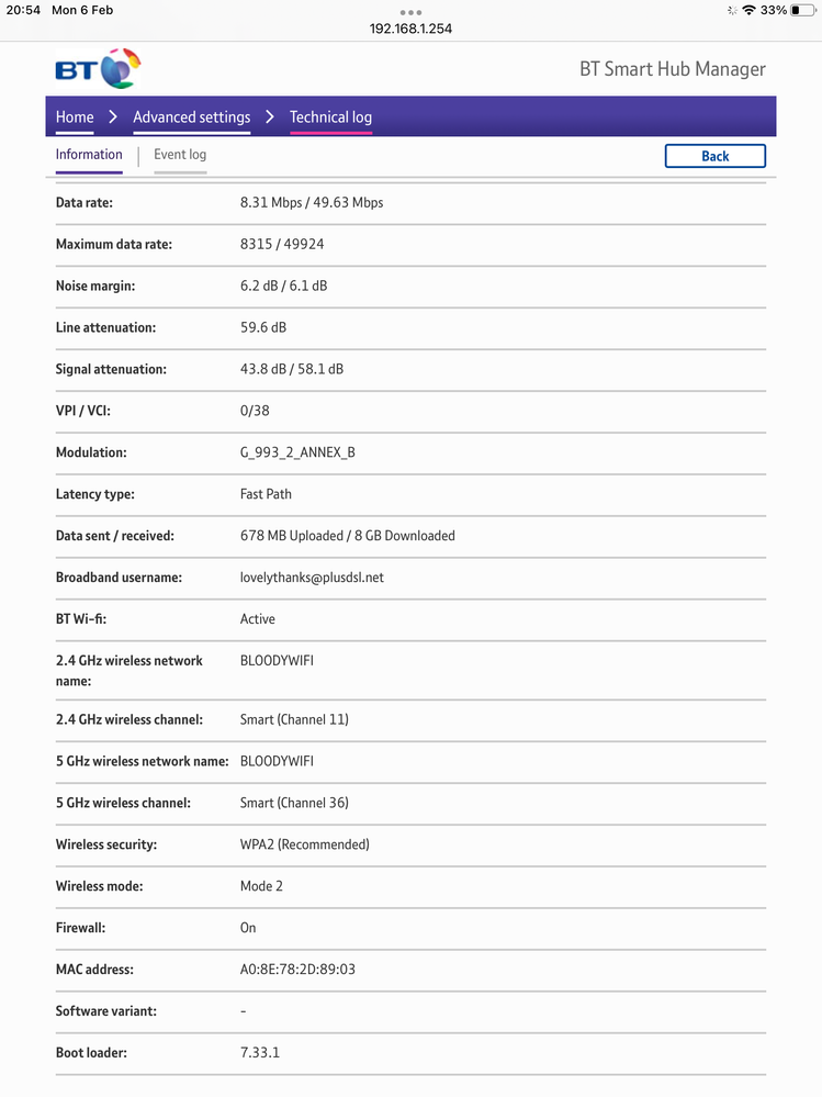

Lovelythanks
Posts: 43
Registered: ‎16-02-2014
Re: Connection dropping
Lovelythanks

Posts: 25,125

Thanks for the Technical Logs - they are showing a very healthy connection speed, given your apparent distance from the street cabinet.
Your event log looks OK, too, once it settled down. Just keep your eyes on the DSL uptime figure - that SHOULD grow, if it keeps restarting, let us know.
