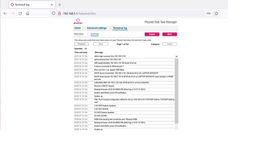

Unfortunately I have never seen the UI of a BT Hub, so can't suggest where to look - best I can do is use the example from a Plusnet Hub2, as below - maybe it might help?

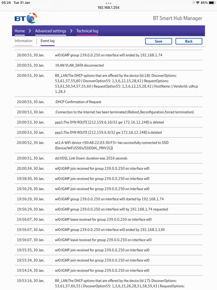

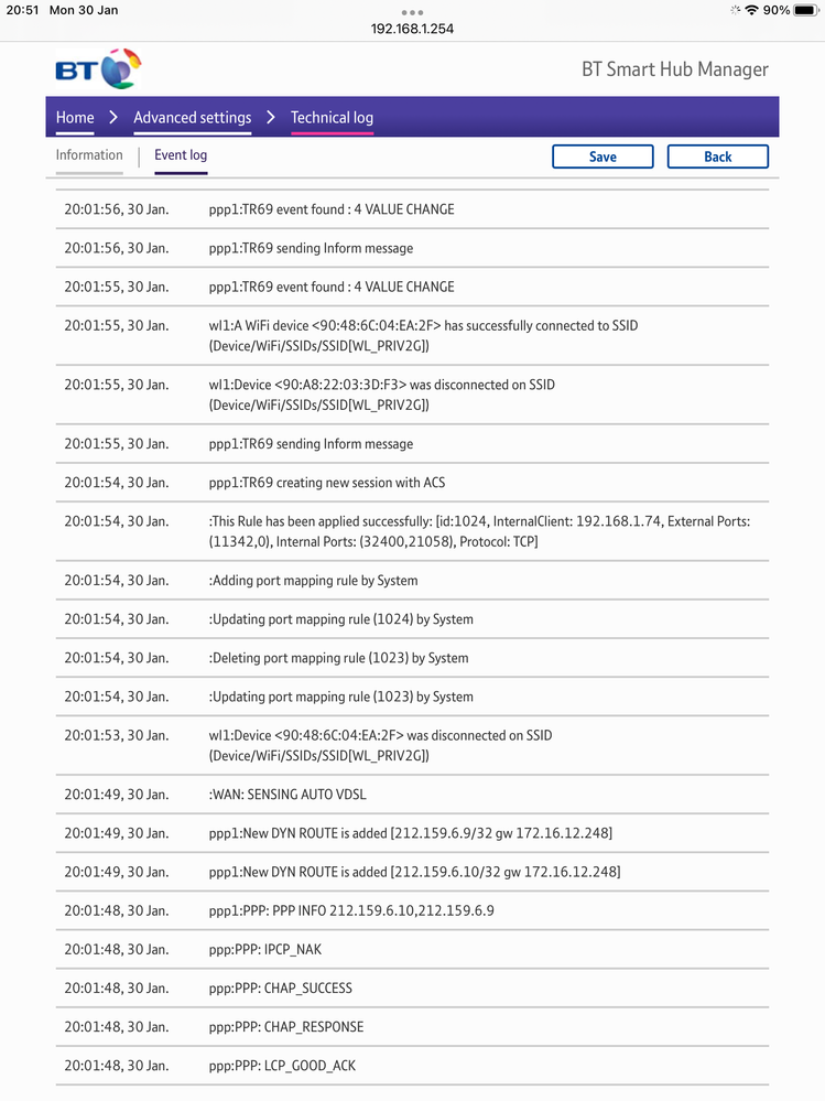

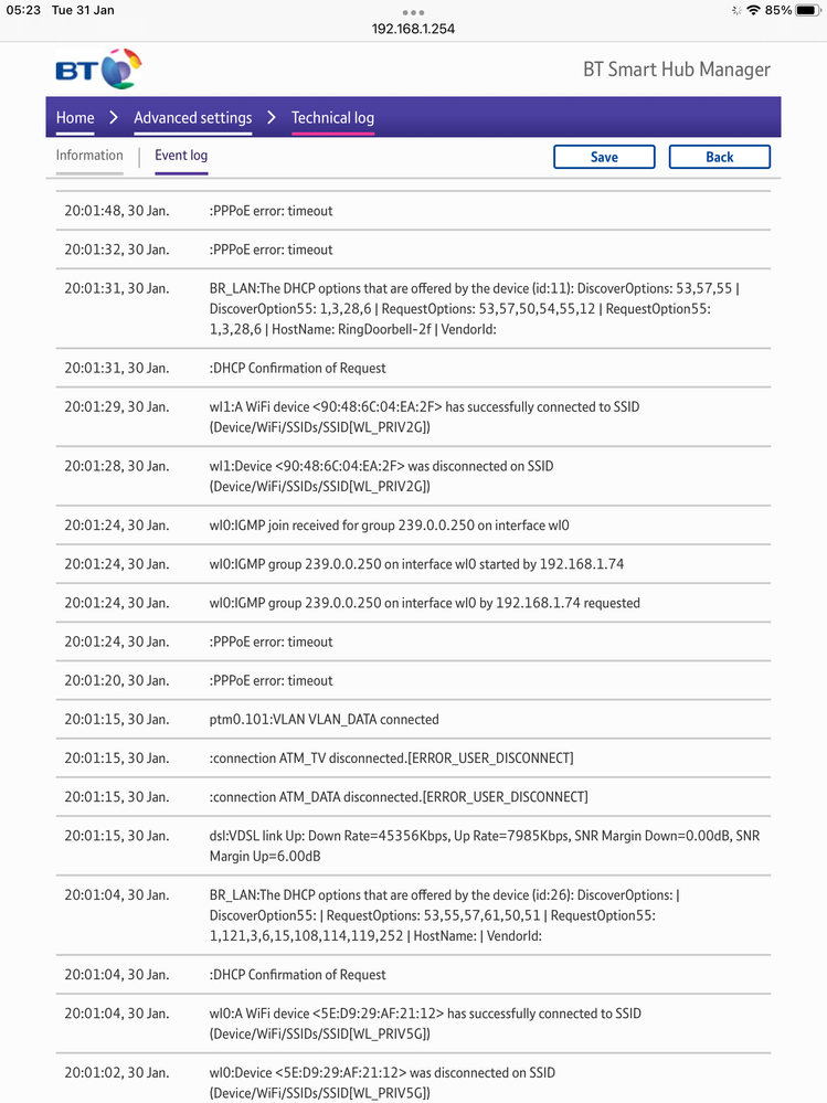

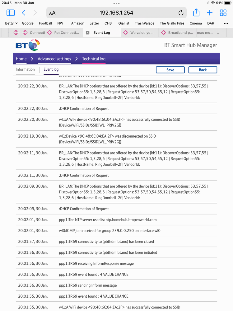

It went off around 8pm and came on again in a couple of minutes.

@Lovelythanks Having looked at those two pictures, I'm sorry to say they are not that easy to interpret (for me), but the bottom entry on the second one is interesting - it suggests you are having PPP drops. Do you have the previous entries, they may tell us a little more?

And here is the EVENT LOG

So last night it blipped off a couple of times and then back on within a few minutes.  I mentioned the OSX change I had made this weekend and that involved reinstalling 3rd party apps, one of which is a PLEX Media server, is there any way that could be interfering?
also noted the ‘ring doorbell’ shows up in the logs, is that it reconnecting when the wifi comes back on?
