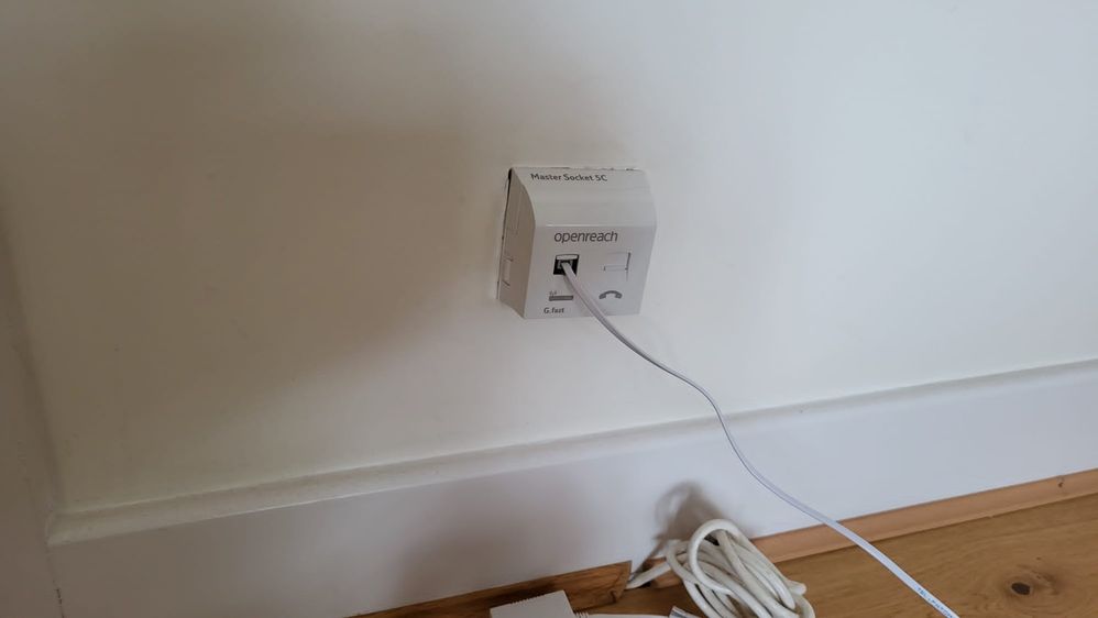

As @Townman said earlier , flashing orange means no dsl sync. That suggests either the Hub isn't connected properly , possibly to a filtered socket if connected to an extension, or the adsl circuit isn't active.
Hence I asked how the Hub is connected and what type of master socket exists

Once we get that, then the next step is to connect the Hub directly to the test socket ( if one exists )

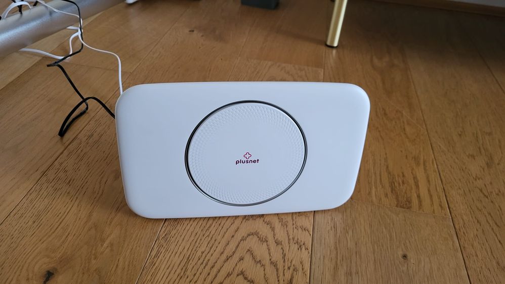

sorry for late replies , just asked parents to take some photos of the hub and and also the connection point 1d9f8bc9-78e8-4571-90f0-b09c925770b1.JPG9a32fbf8-db15-49ce-9601-e5a9aa5cbf2c.JPG16259cd8-f048-43bb-82ba-4bc0b88b2555.JPG

Thanks for the pictures. Can you now unplug the cable from the socket, unclip the front of it, plug the 'dangly filter' supplied with the Hub into the  socket revealed behind it, and see if it springs into life?
