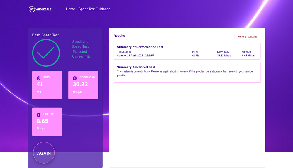

@TJ84 Looking at that screenshot, you are on a very long copper run from your Fibre cab, but you do seem to be at the bottom of the expected range. Which Hub do you have, and can yo please run this test and report the results please:https://speedtest.btwholesale.com/

That doesn't look like the report I was expecting - see below for what I was. As I said, you are a long way from the cab, but your speeds are low.

See attached, cheers
Posts: 22,714
Thanks: 7,933
Fixes: 334
Re: Speed has gone from 20 to 12
OK - that is clearer, thanks. It proves, to me, that your connection is not optimal. If you can wait until tomorrow morning, I will post some further help, but if you want to prod Plusnet in advance:
