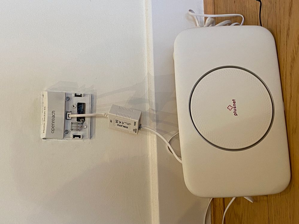

Thanks. That does  look to be connected correctly to what is a filtered master socket.
There's only one other thing I would suggest, that is to remove the front plate of the socket ( it's clipped on at the sides) then use the filter supplied with the Hub to connect to the test socket that will be revealed. Reason being is that its not unknown for the faceplate connection to be faulty.
If that's not possible ( and I appreciate it might not be ) or it still flashes orange, then raise a fault.

I have try the above methods but still there flashing orange light appearing , is there any further steps that we can do?IMG_9547.jpeg

No, you've done everything possible. The only thing to do now is raise a fault with Plusnet

@stephenie If it is still not connecting with the Hub in the test socket as in your picture, then the fault is external to your parents house. This needs Openreach involvement, so - have you had any response to the text messages? If not this needs picking up by the PN Help Team for action - or you could report the fault the 'old fashioned' way by using this link: https://faults.plus.net

The most productive thing which can be done now is to obtain a telephone hand set and confirm that the line is connected, is the right number and without noise.
The router will sync long before looking at the account being activated.
