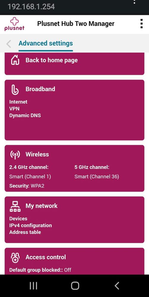

Thanks. Can you post a screen shot of your Technical log page, please - it will look something like the below. Make sure your username is obscured.

I would like to ask where can I find the technical log page ? big thanks

On your Hub - log into it, and then click 'Advanced', then 'technical log'.

2a1e4ee0-1e64-411c-a4c2-e1cd30a907c4.jpg68846f56-59af-4254-8c94-fbed94e6e1b8.jpg71717d74-2f1a-49a8-8c6b-700ef0847b15.jpga7b58174-5a01-40f3-8bcf-6bfbe82c5bc5.jpg

@stephenie Thanks for that. The bit of the Tech log you have provided suggests to me that you have no connection whatsoever.
How long have you been a PN customer, and has the connection ever worked? As @Townman suggests above, have you checked for a working phone line?
