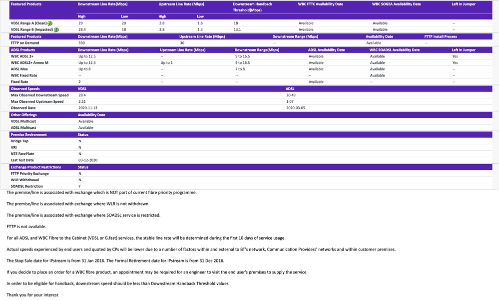

What are the BT wholesale estimates https://www.broadbandchecker.btwholesale.com for your line ? (if you post the results, redact your phone number this is a public forum)

The speeds you're getting are pretty much at the top of the estimates, so that's about as good as it's going to get without moving closer to the cabinet I'm afraid!. As you say, that's the trade off for living in rural area.
